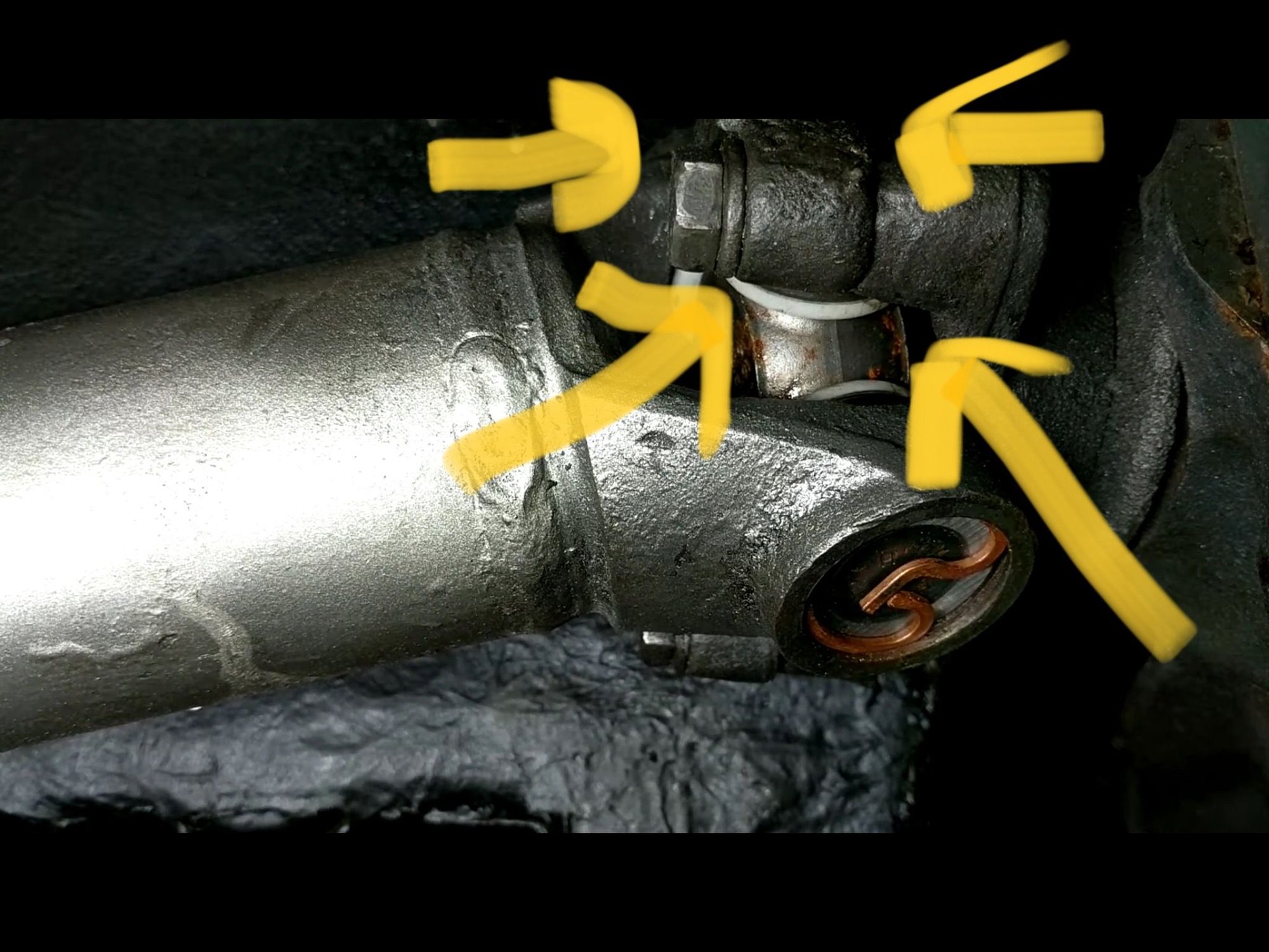

Originally Posted by danc24
Vibrations are tough to troubleshoot. Is it just a vibration or are there any grinding noises too? Did you have the vibration before the shop rebuilt your diff? Any other changes like new u-joints, trailing arm work, etc.?
And when you say you ran it in the air, do you mean you let the rear suspension hang down while on jack stands and let it run? If so I believe letting the rear suspension droop like that could cause the suspension to bind unless you jack up the trailing arms somehow.
Hopefully some of the real experts on here will chime in.
maybe stupid but that u joint in your first video top bolt looks like some slop in it?
