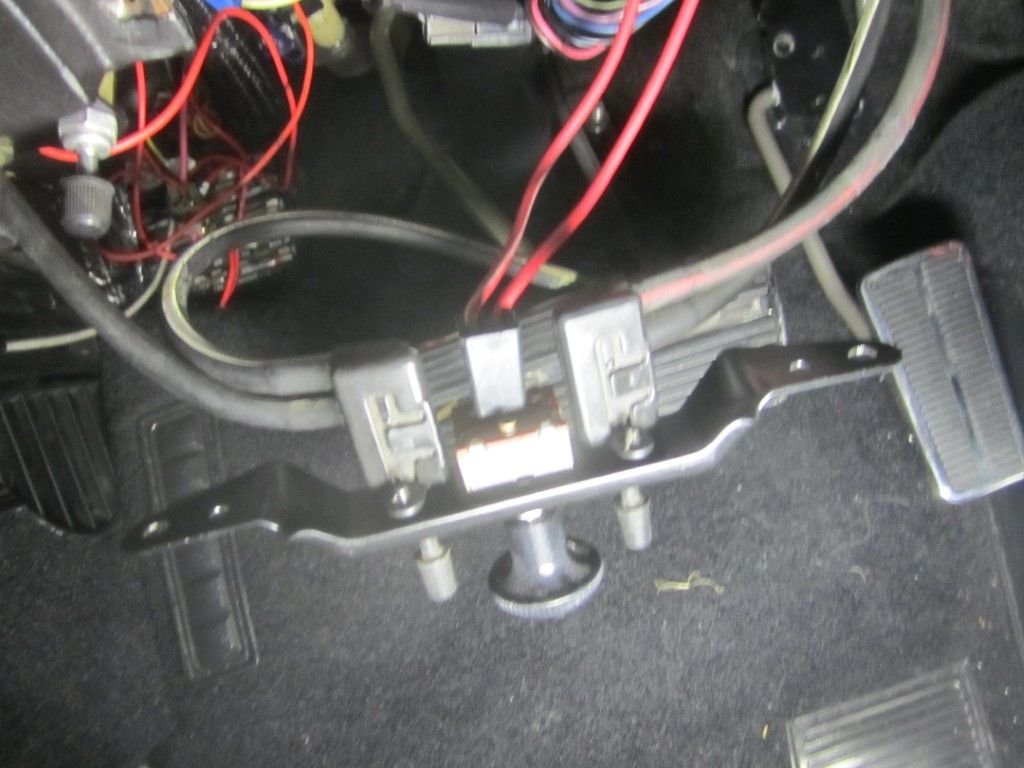

Folks, looking at willcox diagram on hoses 72, on r/h top, right beside the headlight switch, is (in yellow) a little unit and one end of it goes to the pull activator under the column, what the heck is this
unit, cannot find on my car, what does it do. Thanks

Manual override switch (valve). Lets you open the headlights w/o turning them on.
https://www.zip-corvette.com/68-82-h...nder-dash.html

You should have two, one on each side of the wiper override ****-switch. One to open the headlights and the other to open the wiper door.
