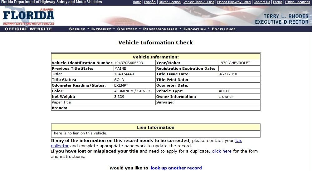

I don't know the car, but it looks like it went from Maine to Florida in 2010, and according to you it's now in Wisconsin.
Also, did you see the car on the C3 registry?
https://www.c3registry.com/index.php...dFbntcrQ89W5Pw

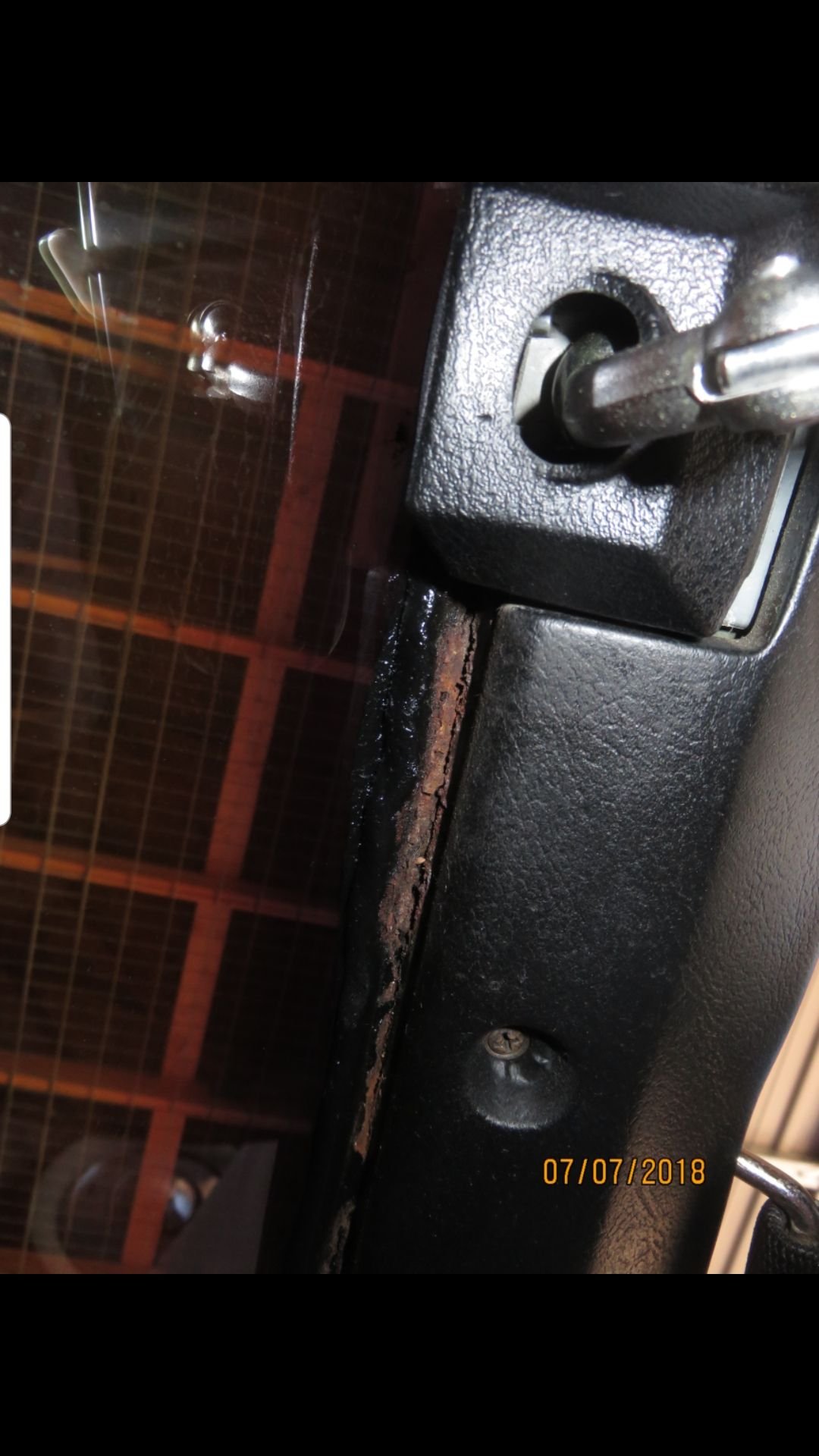

Header trim from inside looking up
I asked the owner to take off the interior a pillar trim to check for windsheild condition. He was not able to get the screws out which tells me something. He did take a couple photos and stated he could see rust all along the header as shown in the photo.
So it does appear that the rust flakes in the body mount pocket are coming down from a rusted windshield support.
I told the owner I would have to pass.
Thank you all for your input. This forum is a wealth of information!!

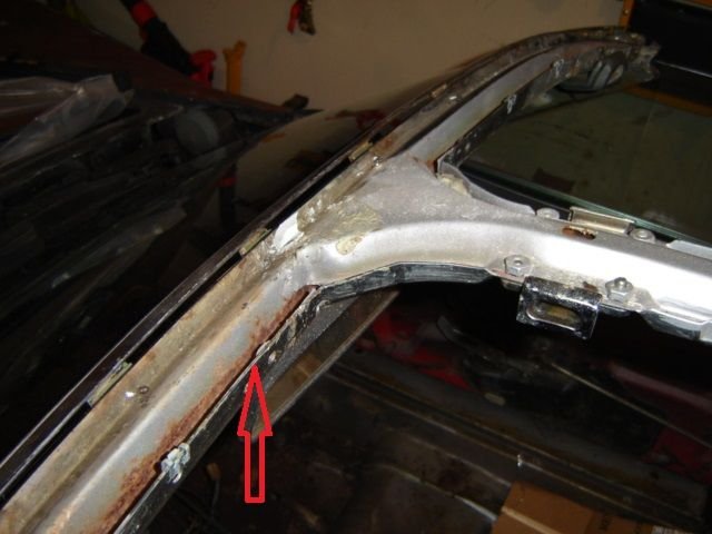

I agree. Here is a pic to make your point. In this case the rust that is visible in the seller's photo that he sent you (if I am looking at it right) just possibly may be limited to that leading edge and the worst area on the entire frame like it is on this coupe. But it also could just be the tip of the iceberg. I keep thinking about that rust pile in the mount pocket and I think you are wise to pass it up. Don't mean to drag this out but when I saw that pic he sent you it reminded me to look at some of my old pics and this popped up as a good example of how you don't know until you do the deep dive on these things.
