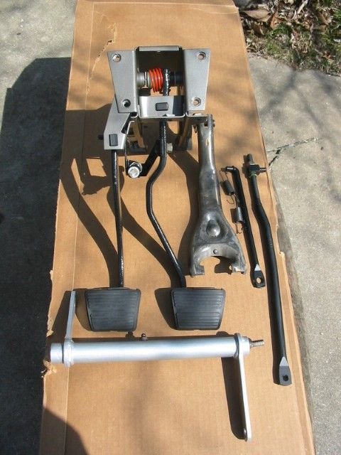

Originally Posted by Carguy1337
Hey guys I have a 75 corvette with a motor (450ish HP) and it has the original 3 speed and I want to put a manual in
I have everything below available,
if you or anyone else is interested send a PM, all in bolt on condition
