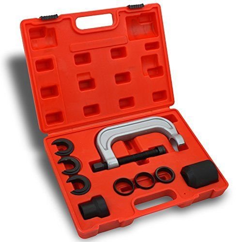

I purchased this Control Arm Bushing tool a couple years ago. I use it to remove the old bushings and install the new bushings. It has saved a ton of aggravation and it doesn't bend the A-Arm.
Hopefully I can rent one from an auto parts store. Thank you much sir!

I have the same tool as shown by slapjack9. It presses out the old bushing and presses in the new bushing without damaging the control arm. Check on ebay for "GM control arm bushing tool" for about $40.
