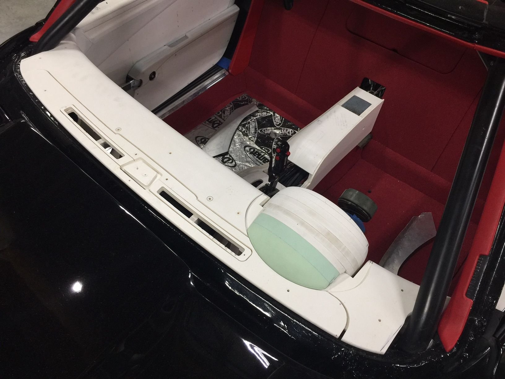

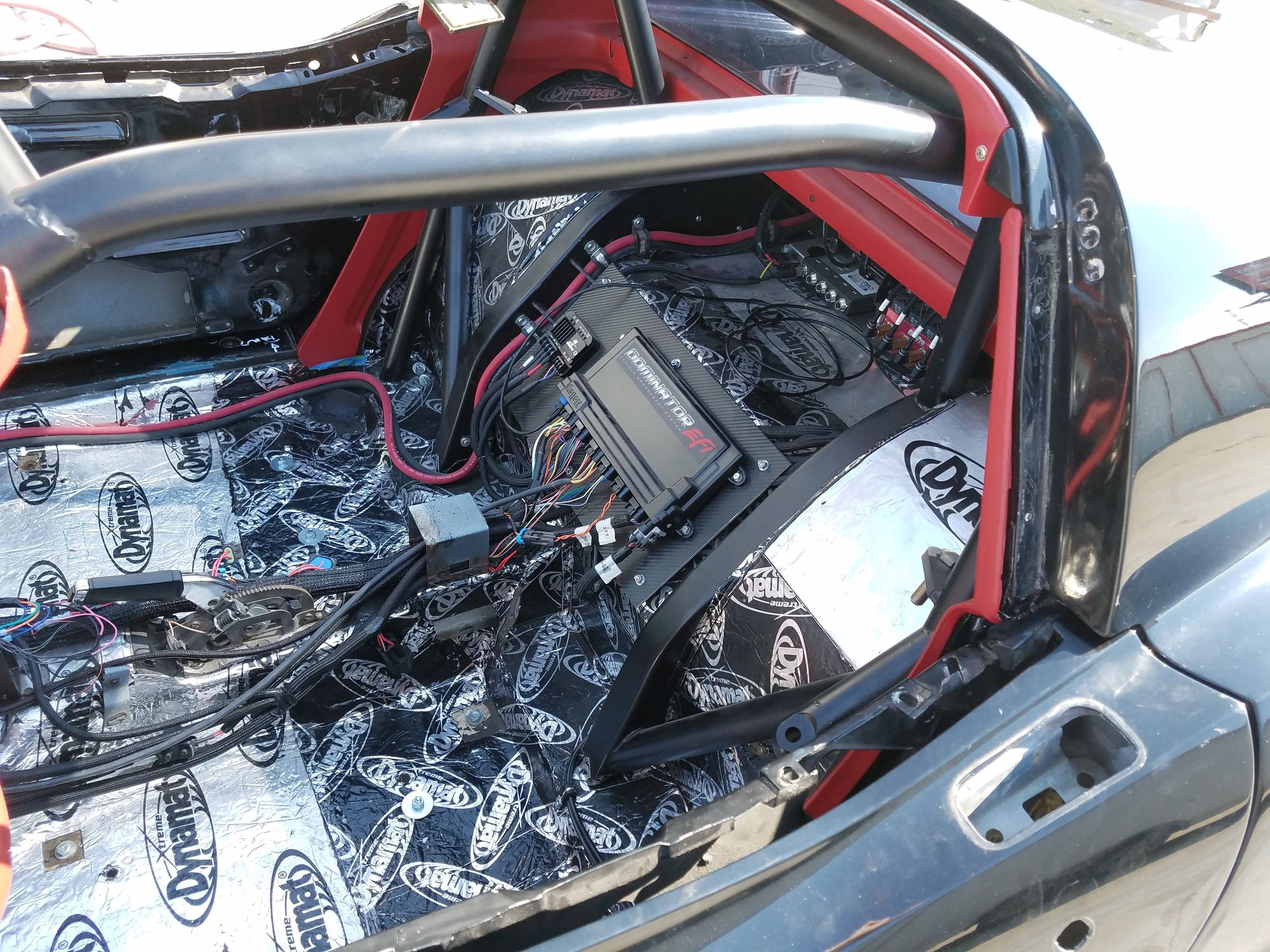

Rear area closed in with access door

The white pieces are all expanded pvc board cnc designed and cut using waterjet. Lightweight, waterproof, strong, and easily bonded. (the board in an earlier picture was a mock up before transitioning to pvc)
