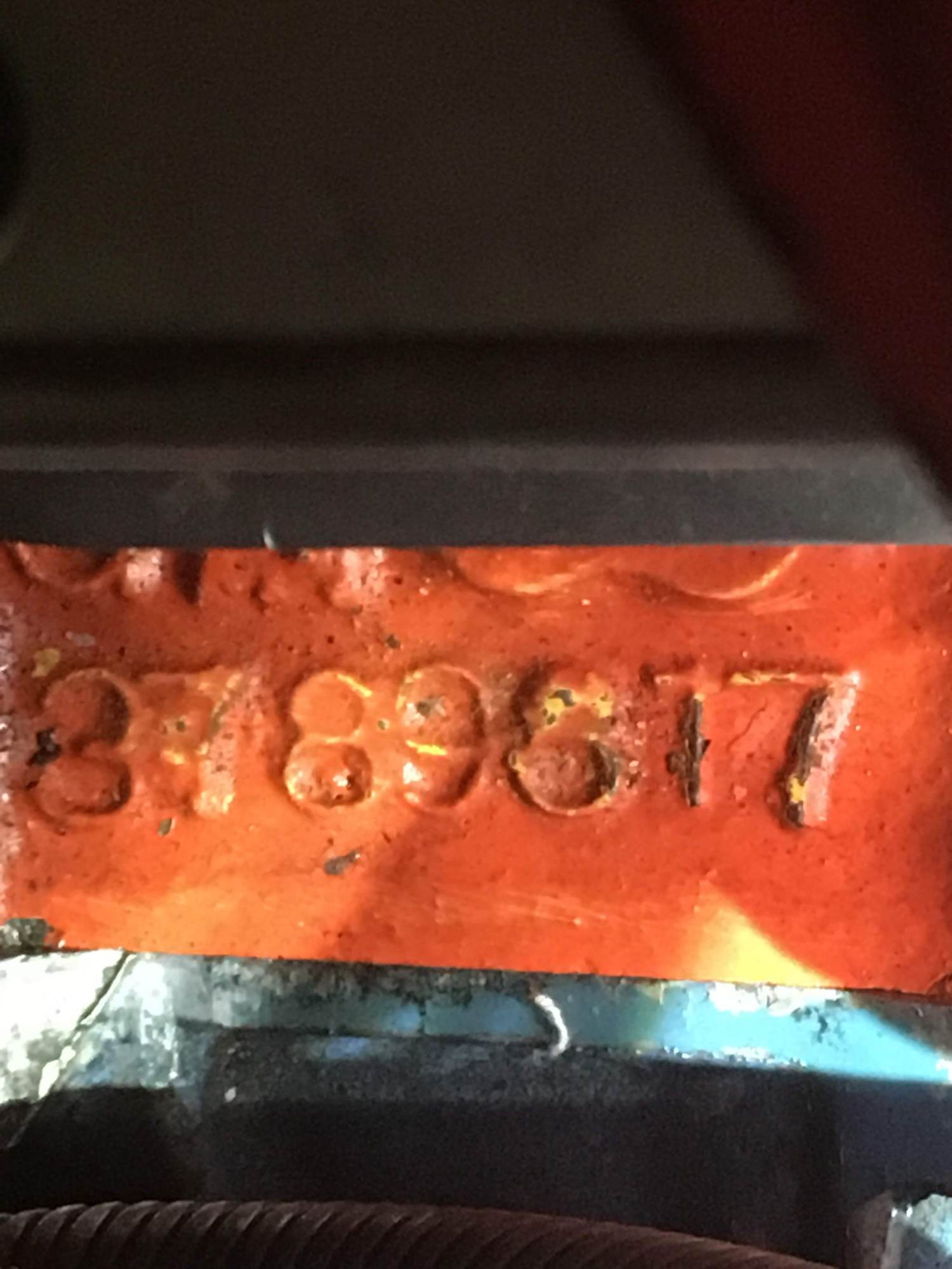

I just bought a used 1981 with a 383 in it. I know the engine isn't from a 1981 because the oil dipstick in on the wrong side. Looking for more info on the engine, here's the code from the firewall side of the block. https://imgur.com/a/vsazW0g

The casting number looks like 3789317, but nothing comes back when Google it. Is there an engine ID stamp on the pad?

That's the stamp on the back side where it meets the transmission. Where is the ID stamp pad?

The only cast number the resembles what you have 62-67 327. I have not seen a small journal stroker, it's possible to do. The original Grand Sports had 377 ci.

S indicates a 62-64 327 250 hp generic passenger car engine.

So, the guy lied to me then, great.

It's not a Corvette engine and, going by the engine suffix, it's not a 350. That said, it might now be a 383.

Small journal block. Not likely to have more than the original 3.25" stroke.
