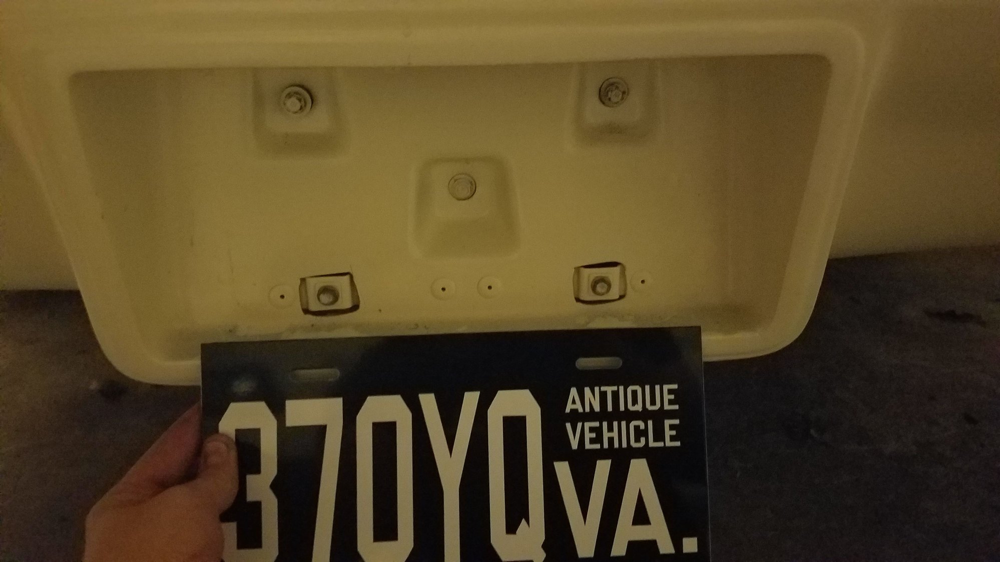

I cant believe I have to ask....
so good news is that my Vette finally has license plates and insurance!! And once I finish wiring up the temp. Sending unit tomorrow, shes off to the alignment shop!!
Now, you'll notice I said I finally got license plates, and I hope that a few of you know where im about to go with this so i dont feel so dumb..
in VA, antique plates only have top mounting holes, something that GM did not agree with back in the day, so what's the best way to mount this bad boy without having to drill holes in the bottom of my plates??
As for the front... my license plate holes line up with the larger diameter holes, where you will notice there is something hidden behind it.. it appears to be fiberglass.. if I drill through that, will it be sturdy enough to mount my front plates??
thanks and dont judge!

P.s. the screws you see for the rear plate are indented into the bumper so as to not allow a plate mounting right there... is it just as simple as buy longer screws?

Lots of plates only use the top screws and then a rubber bumper behind the bottom to keep it from rattling, any reason your's couldn't do the same?

I think longer top bolts with a spacer behind the plate to fill the cavity would be the easiest route?

ok I'll give that a try tomorrow! Any thoughts on front bumper? Can I drill that?

The plate is not an antique. The car is. Don't re drill the car. Drill the plates to fit the car.

See if you can find a couple of strips of flat bar or whatever and make up something that bolts into the bottom holes of the car and then you can put some of the plastic retainers in the top to screw the plate to

all the holes in the front bumper are for a plate bracket. https://www.ebay.com/itm/Corvette-C3-License-Tag-Mounting-Bracket-OEM/292625094383?hash=item4421d096ef%3Ag%3A0 Z8AAOSw4CFY5AtB&_sacat=0&_nkw=c3+corvett e+licnse+mount&_from=R40&rt=nc&_trksid=m 570.l1313
And on that bracket, it has these mounting style bolt and press in nut. https://www.ebay.com/itm/4-Chevrolet...LH_TitleDesc=0

When I was working for MB they used to bring a lot of grey market cars in which were set up for european plates, we had license frames that were a thin chrome frame that mounted to a separate metal back and held the plate between you drilled the back metal piece to fit the hole placement slid the plate in and then the frame on top. If yours is like my 77 those rear upper bolts hold the cover onto the bumper bar. I myself would put holes in a $20 frame before I’d alter the car.

will the cheap plastic license plate plugs fit in there that you get in the help section of the local parts stores? like this
https://www.autozone.com/license-pla...rew/464528_0_0
other solutions
mounts
https://www.autozone.com/license-plate-and-accessories/license-plate-bracket-and-frame?filterByKeyWord=license+plate&from String=search&isIgnoreVehicle=false
fasteners
https://www.autozone.com/license-pla...nting-hardware

If you run standard tags, you get to pay property tax, and tag renewal and inspection every year. I didnt think to get the other antiques, probably should have, but too little too late. What I eneded up doing (that worked) was getting a $15 plate frame from autozone like suggested, and then only mounted the plate frame by the bottom bolts, giving me access to mount the top of the plate to the top of the frame. And in the front, I got the plastic retaining clips like everyone suggested, worked like a dream!
