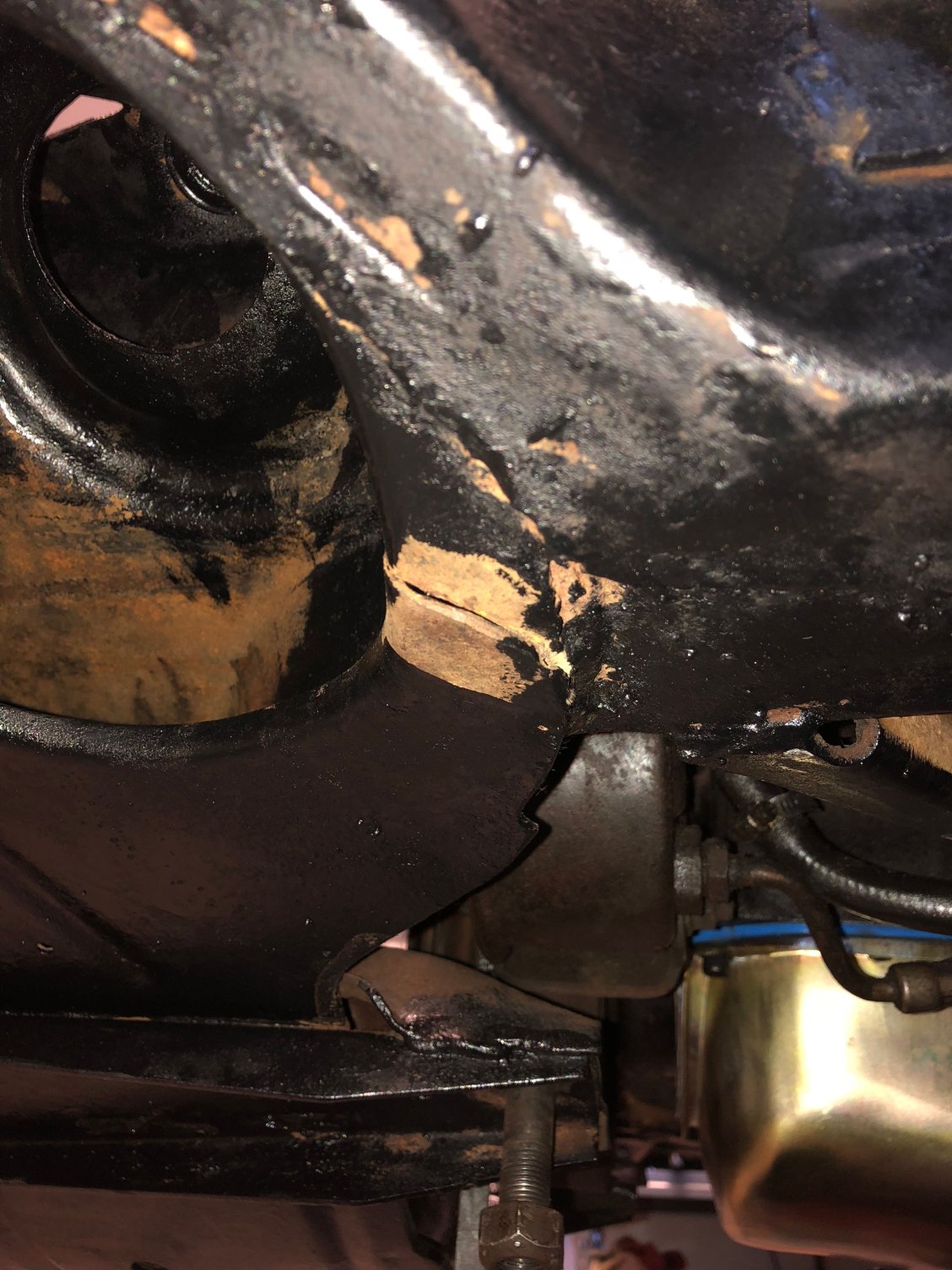

Default Frame crack, how bad?
near the spring slot and control arm mount. How bad?

Wire brush it off (rotary air driven would be easy) and show us another picture. You probably want to do that anyway to get an estimate...unless you're going to weld it yourself.
I'm planning on doing it myself. Would a weld suffice?

Odd spot for a crack. I would clean it to see just how big it is. Weld it up. Should be an easy fix.

If it was me, after taking the area back to bare shiny steel;
I would drill the end of the crack to stop it propagating, grind the edges of the crack to a chamfer to ensure full penetration and straighten the two sides to remove the slight 'step' you have.
Then weld it up.
If you want to go further, then grind that weld flat and weld a piece across the repair to add strength.

Originally Posted by Blue Juice
I
This
Then weld it up.
That's what I would do. Doesn't look horrible or anything. Clean it really well and it should be an easy weld and it's not terrible thick metal to begin with .... the metal plate to strengthen is another good idea.
