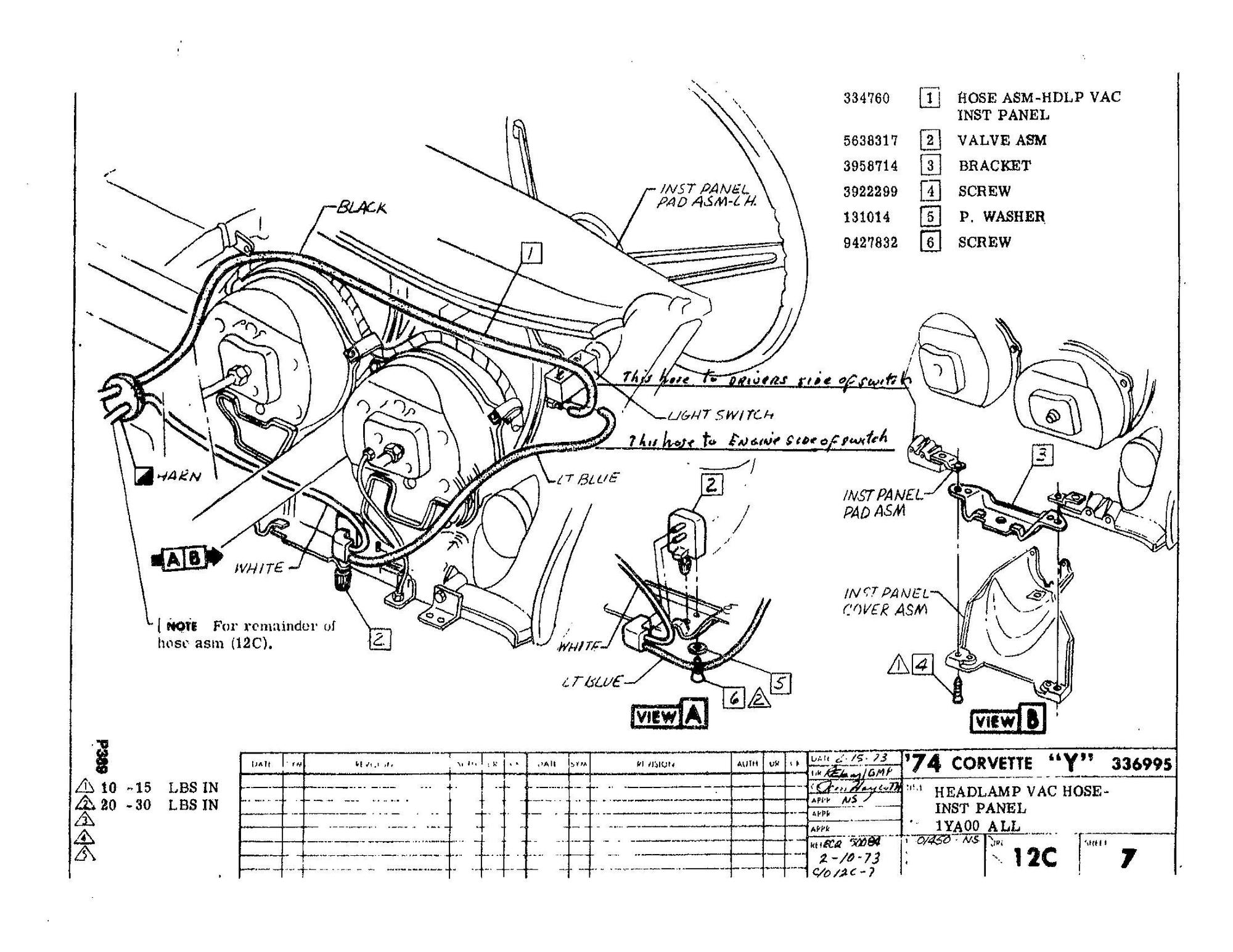

Hello Guys, need help with lights. Just replaced the light switch on my 74 c3, the old one didnt open/close the lights, the new one works but the wrong way, works the other way around. When pulling the light **** out the lights go on and they close, Pushing the light **** in couses the lights to shot off and open. Any advice where to look for answers? I switched the vacuum hoses and dosent help...
thanks alot
