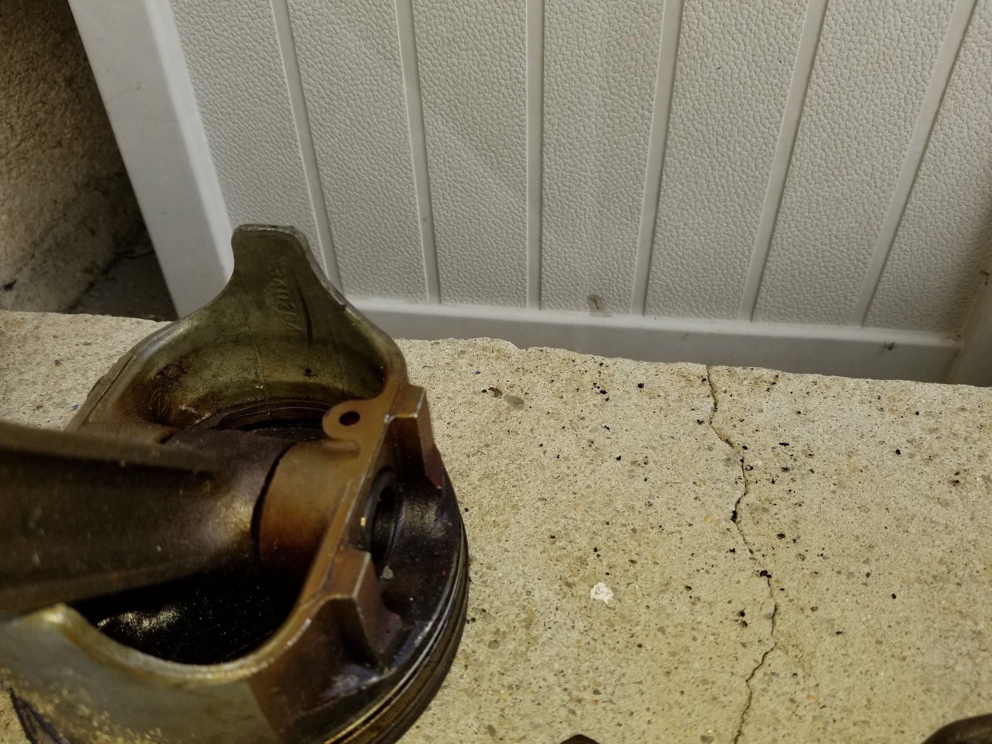

Pic of casting number inside skirt of piston.
