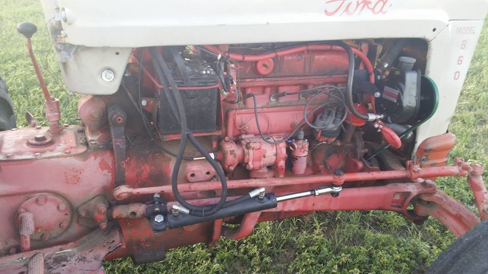

Does this Ford Tractor power steering look familiar?
Now that is funny. I love it. Thank you for sharing this.
