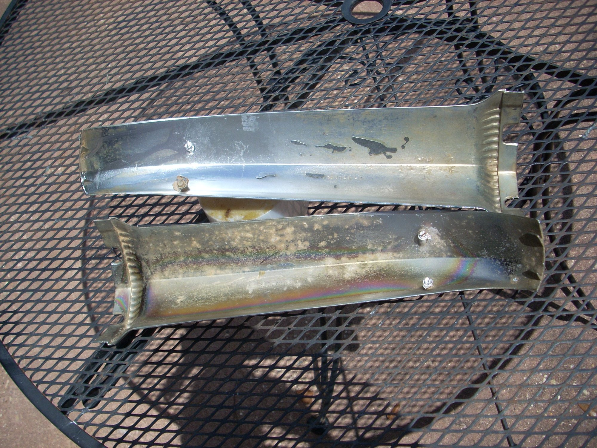

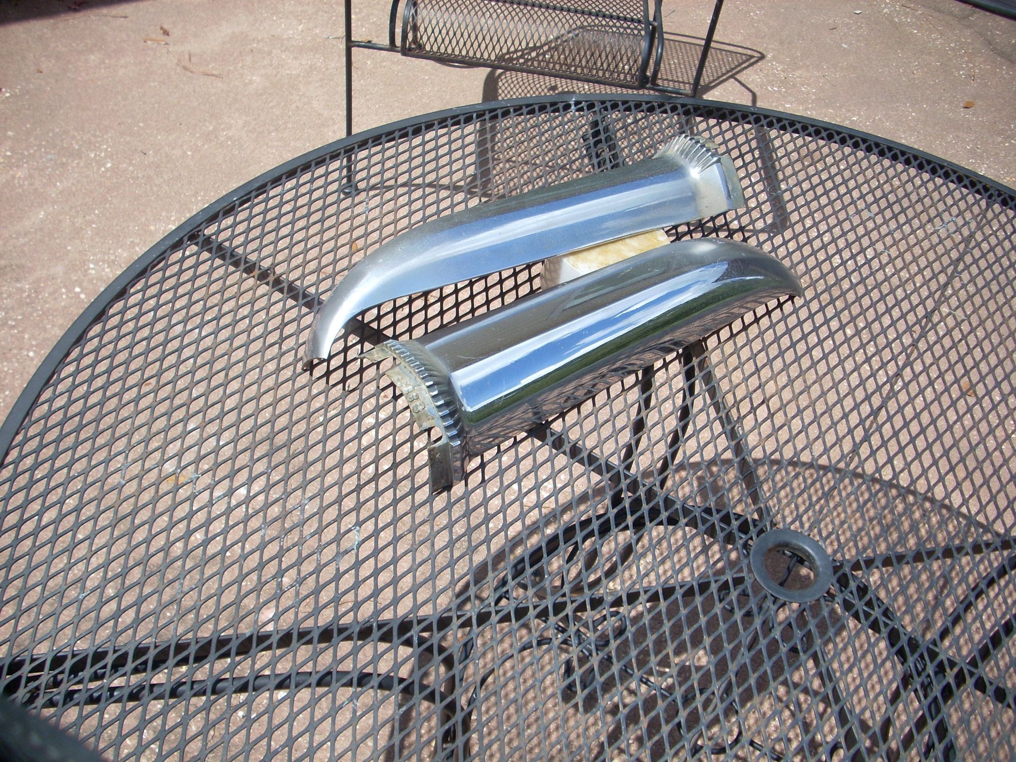

OEM side exhaust front shield, is this what you are looking for?
photos of cut short and photos of original length. I think people cut them short for tire clearance maybe?

Thanks for the pics, I was hoping for a pic of the shields on a car. Sorry I did not make it clear.

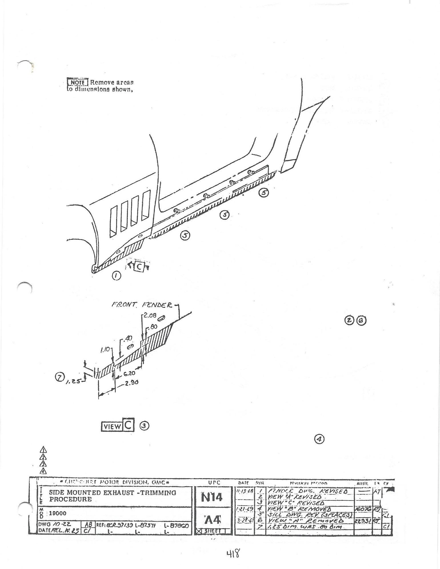

When I hold the shield to the rocker and the front of shield is in place (around the fender) it looks like the back of the shield is to forward. If I hold the back of shield in what I think is the correct place the front of shield hits the lower rocker and is about an inch back. So I think the front needs to be in place or the lower fender needs a slot for the shield to fit in.

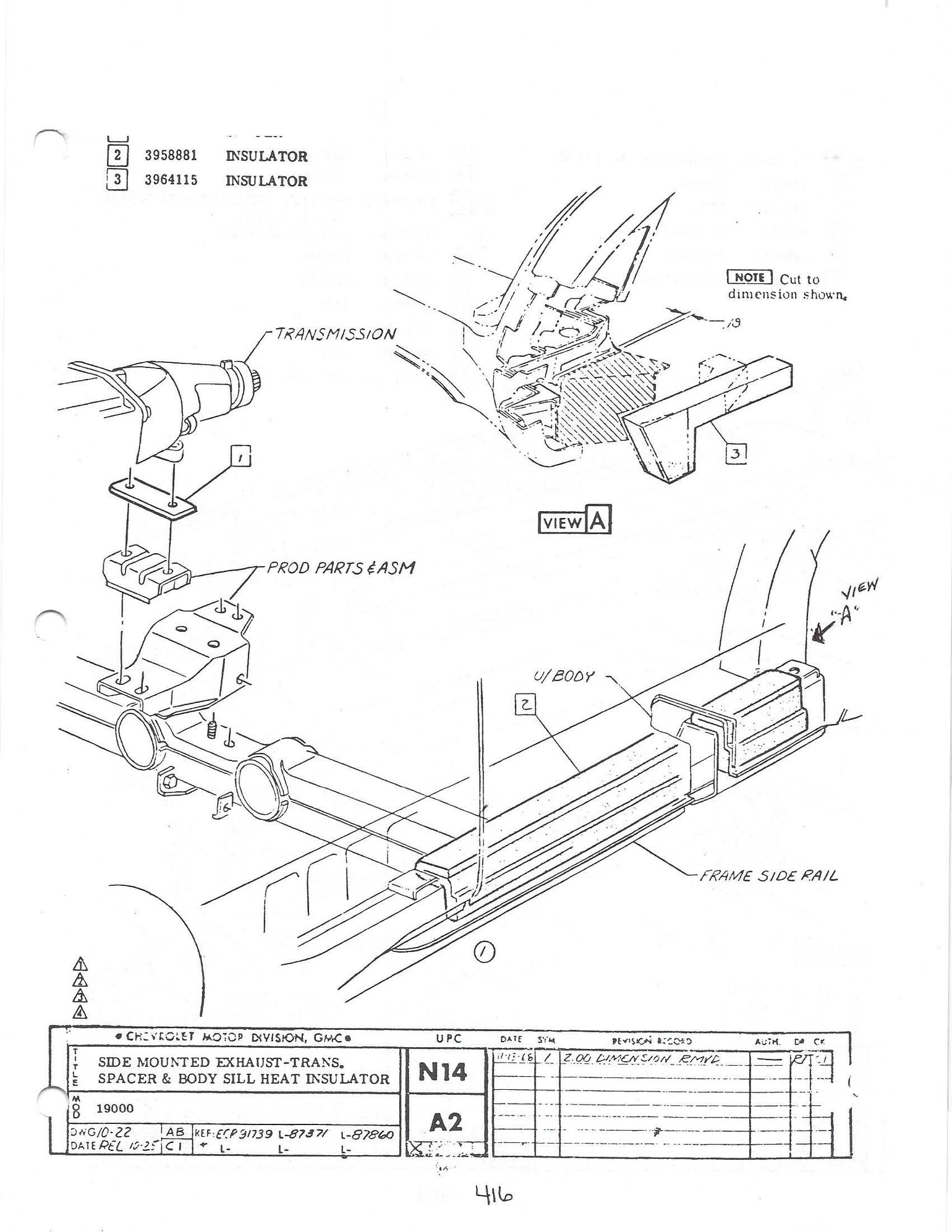

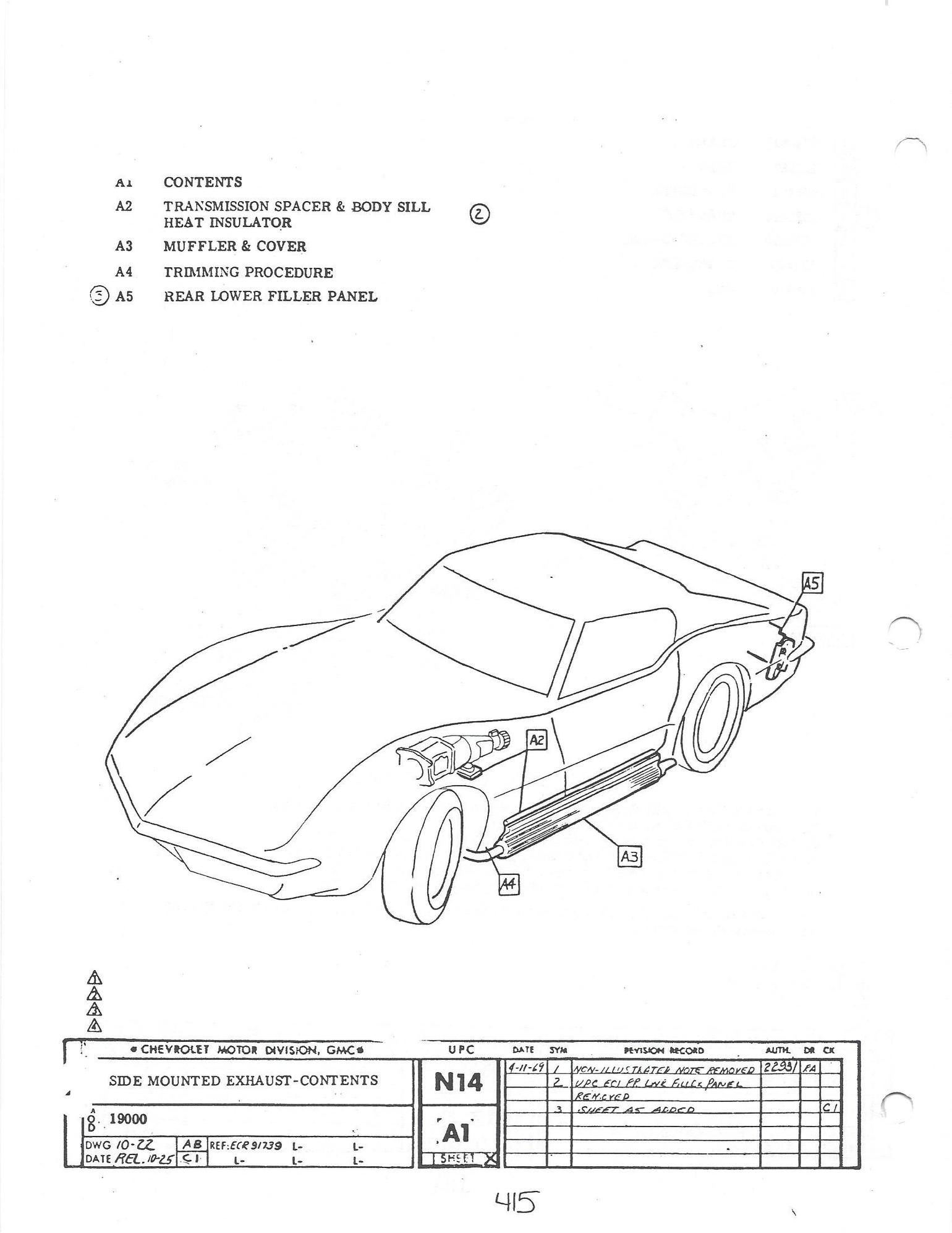

The front lower fender lip does need to be trimmed in a couple of places.
The info is in the AIM.
