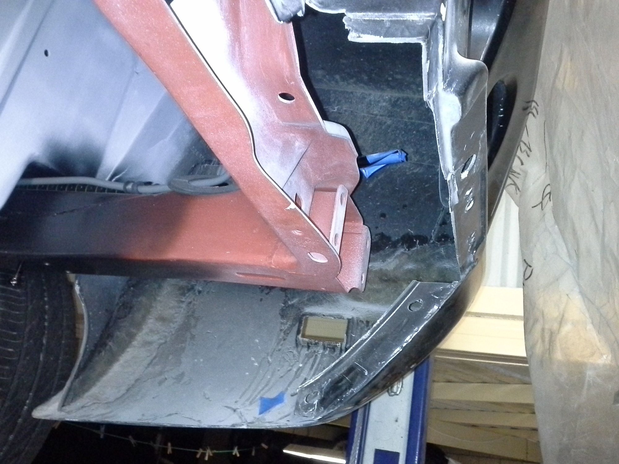

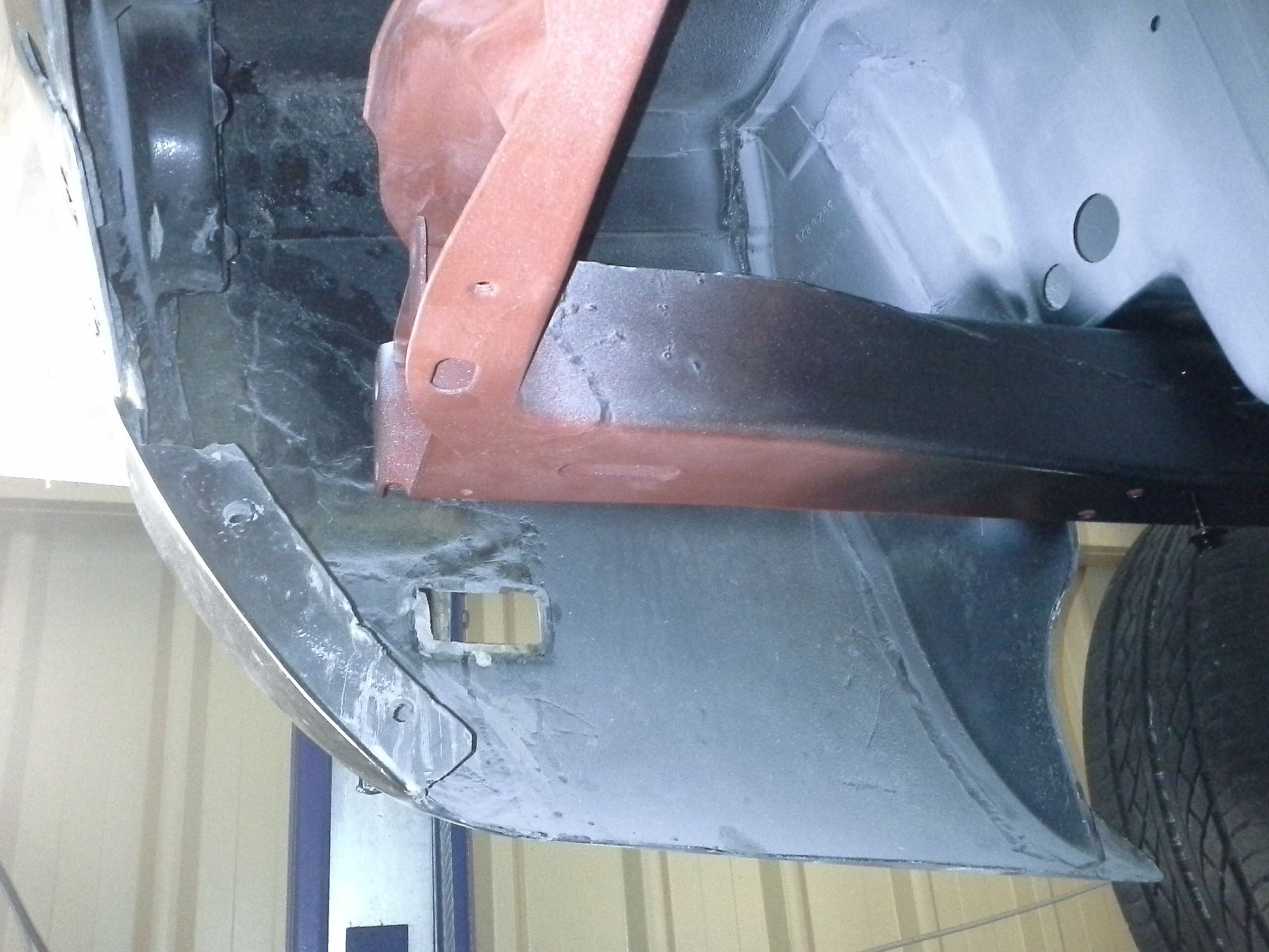

I went through this while looking for a replacement frame for a 69 . From what I discovered on this forum by reading dozens of threads ,was at one time GM sold the 74 frame as a replacement for the earlier c3 frames.
I ended up getting a 78 frame to replace a 69 and have just started getting it to fit , at the front it's just a matter of adding two extra holes in the 69 extensions to match the bolt pattern in the 78 chassis. I think your crash bumper "battering ram " is the equal to the 69 extensions , but its the same fix . As for the back I will just make the pieces fit when I get to it !
Believe me I tried and tried to get a 68-72 frame so hard to avoid all this but they are worth their weight in gold now, mostly because as soon as the seller realised where I was the shipping cost went through the roof . You being more local will have better luck finding one for a reasonable cost.

69 body on top of a 78 frame , went on easy enough , but with the exhaust panel off. I ended up cutting the tabs that stick sideways at the back off.

That' a 69 extension , someone (Not me ) already opened those original holes .My car was badly smash repaired before I got it. The white marker is my wor k at where the new holes went to make it fit on the 78 frame !..

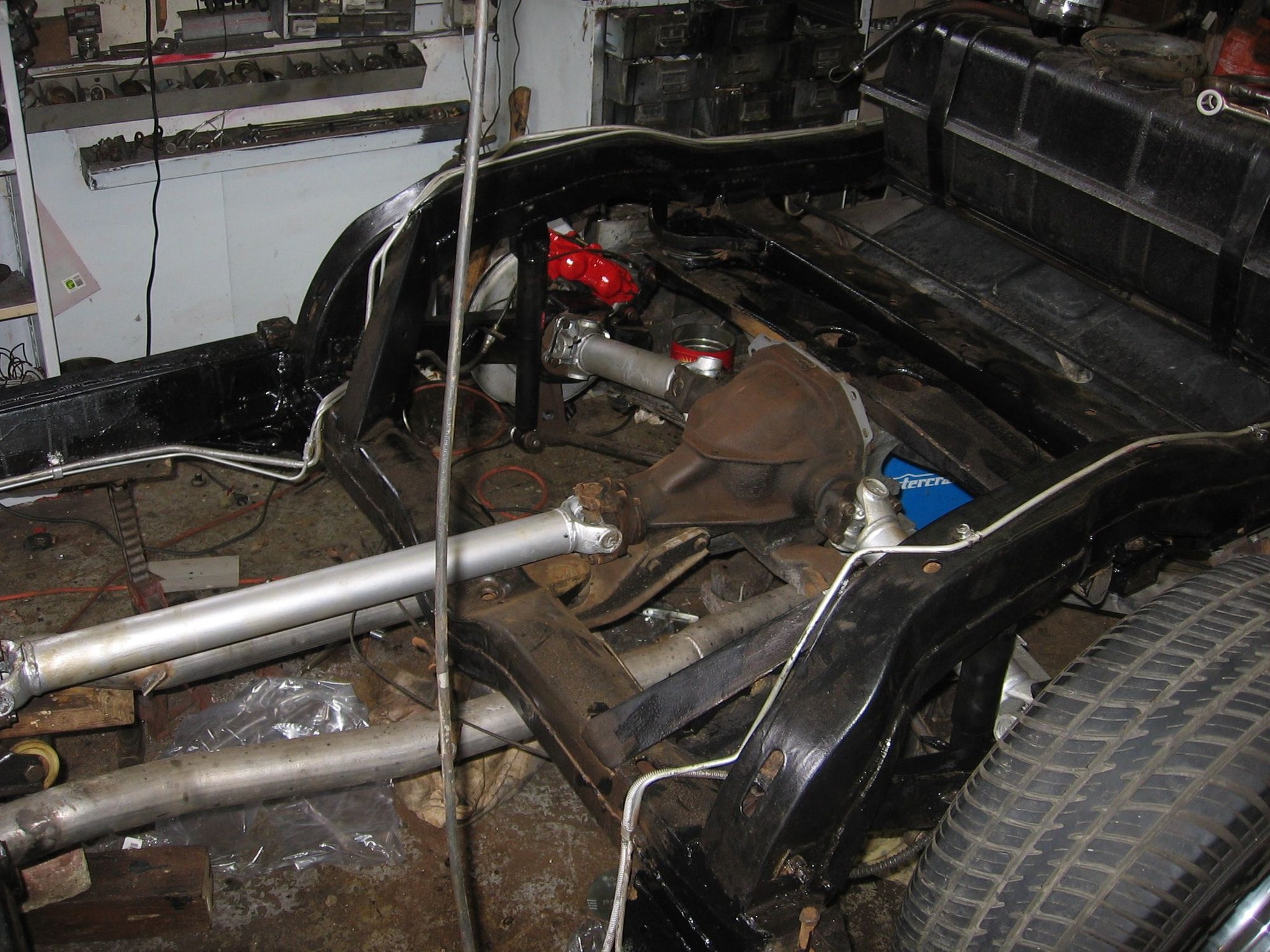

Hi, I have done many frames, for the 68-72 I just keep the old rusted unit cut off last 3 feet and weld to newer frame, usually the rust frame is bad in the middle and where the swing arm attaches, a good sandblast solves the problem
with the back 2-3 feet, very easy to weld and "hide" the changeover, any good welder can do this, easy alignment. Mike.

[QUOTE=jsbwac;1597998363]It sounds like the front is the same, just use my existing crash bar and bolt onto the frame ends. Any idea what it would take to get the rear to work? If I can sit the 74 body on it, and adjust that, or would I need to cut and weld the back half, which I really don't want to get into.
BODY mounts exactly the same, very very easy to cut back part and weld, a small mig wlder (wire feed) is what I use, weld the heck out of it, grind, reweld parts missed, grind again, a small amount of putty to hide scratches and no one will know,
honestly 6 hours work, . attached is a pic of one I did last year, sorry, but do not have pic of welded area, just finished, this is a daily driver guys , so did not go to crazy.
