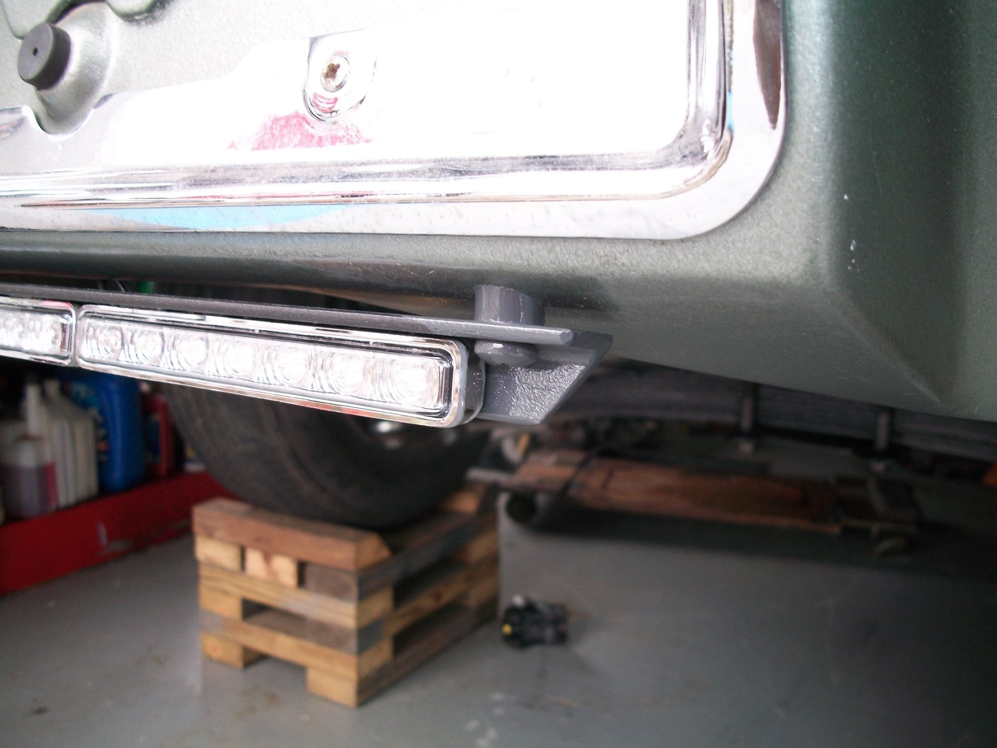

another thought. Go with the double tail lights with no backup lights in them. And then do something like the license plate frame with the LED backup lights built into it.
I tried that, but the LED license plate frame... at least the one I bought... would not fit inside the stock chrome bezel. So I cut the LEDs off the license plate frame, and mounted them underneath on a piece of scrap 1/2 by 1/2 angle iron.....
