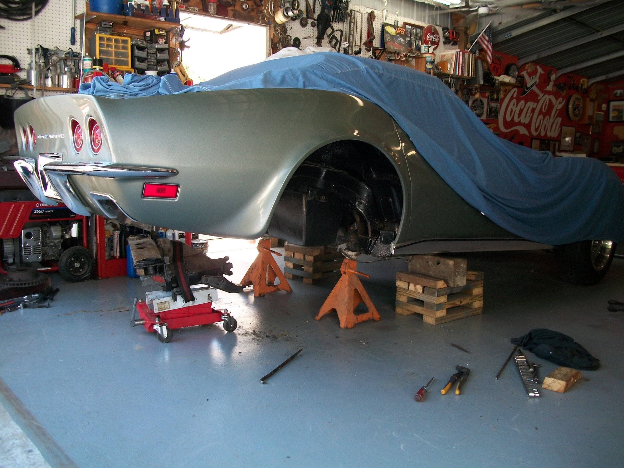

I always leave the jack engaged even though the car is up on stands. Just a safety check!!! Ike

Thanks for the heads up on engine stands! We built wooden tire cradles, and we use them as a back-up when we have the car on jack stands....
