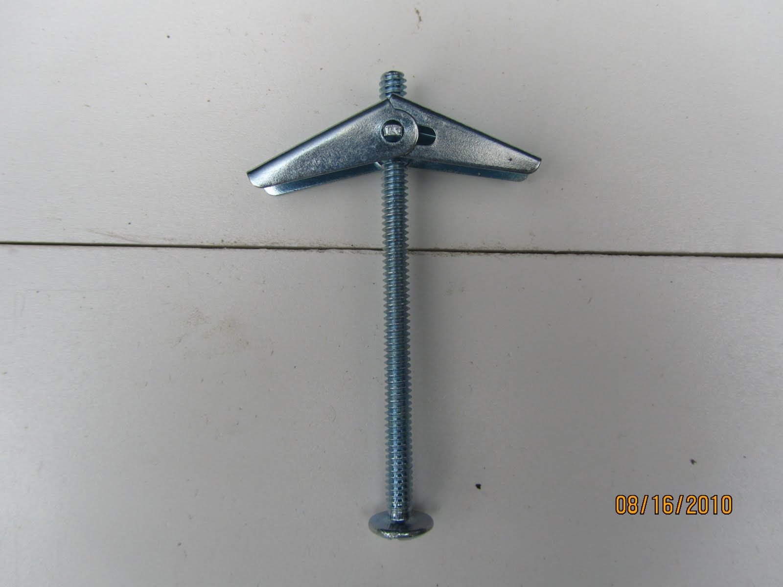

I replaced my passenger side mirror with a new one after my car was painted. No matter what I tried I just couldn't get it to tighten up properly. The new rubber inserts didn't seem to hold the base tight enough and I could always move the mirror around. It was just sloppy. I tried half a dozen different "fixes" and finally got it figured out. I pulled the rubber plugs back out, tossed them and installed a couple of these screw type drywall anchors. They fit the same hole fine, I trimmed the screw length a bit and then I was able to tighten the base up as rigid as the original base was. Re-installed the mirror and it's tight as can be now. Sounds like a goofy repair? Yes, but it works perfectly and nobody can see it.

Oops, sorry. I think I misunderstood. It sounds like you're having a problem with the head of the mirror not the mounting bracket.
