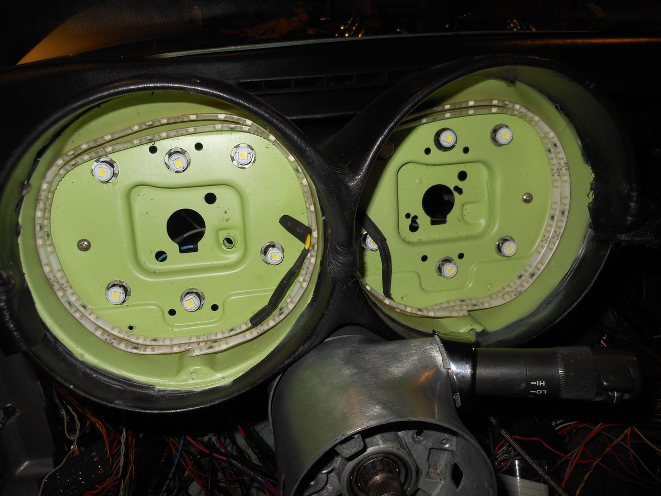

Depending on how much effort you want to put into this. Here's my exercise with LED strip lights. Dimmable and various colors. I like them, but it may not be everybody's cup of tea:
https://www.corvetteforum.com/forums...-and-tach.html

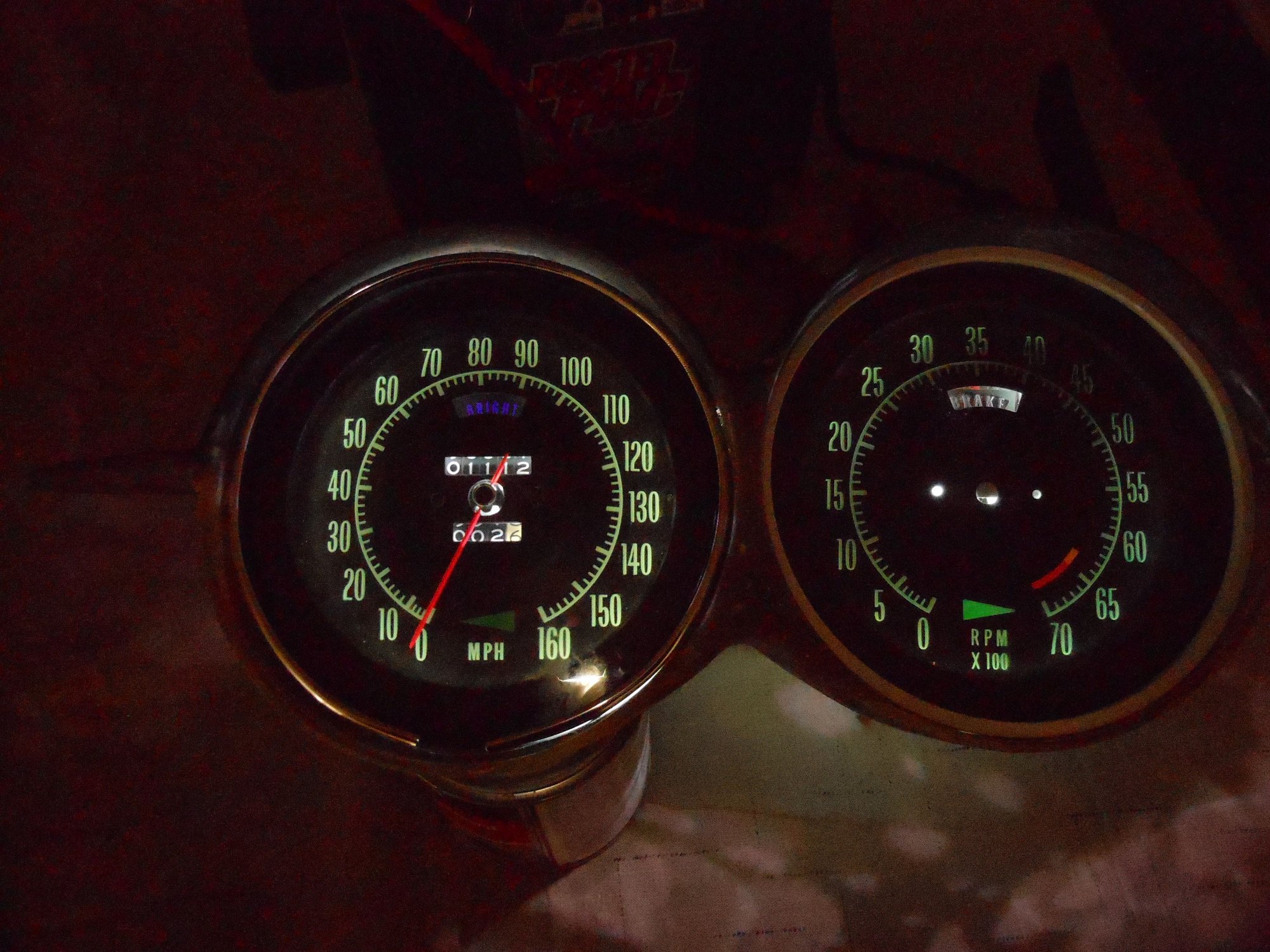

I used LED bulbs AND LED strips- I didn't want the LED look...I think I've accomplished it-
Guess which side is LED???
And they are dimmable- but only to a certain point

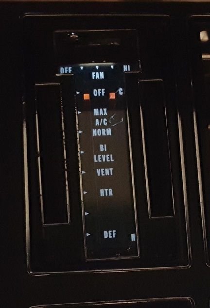

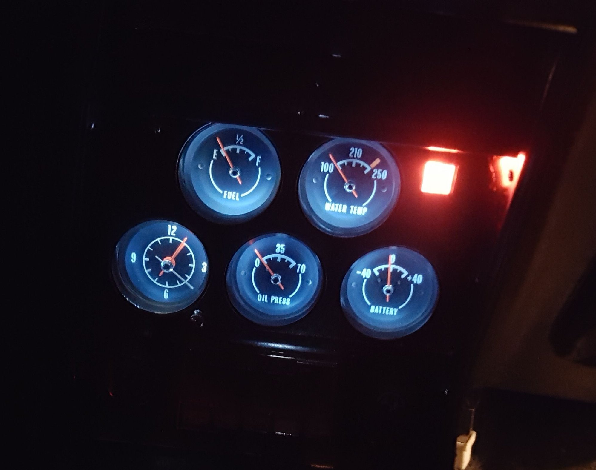

When I replaced my gauge speedo and tach lights, as well as those in the console, they would not dim. But I like bright lighting, it was night and day to incandescents. And I did not use green ones in the signal lights and they still flash green. Here's some pictures of the lights after installation, I believe someone was looking for some (of course I was in too big a hurry to have 'before' pictures before making the change). Before, I could not even see the HVAC controls, now they are lighted up nicely.
