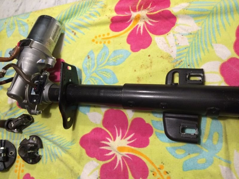

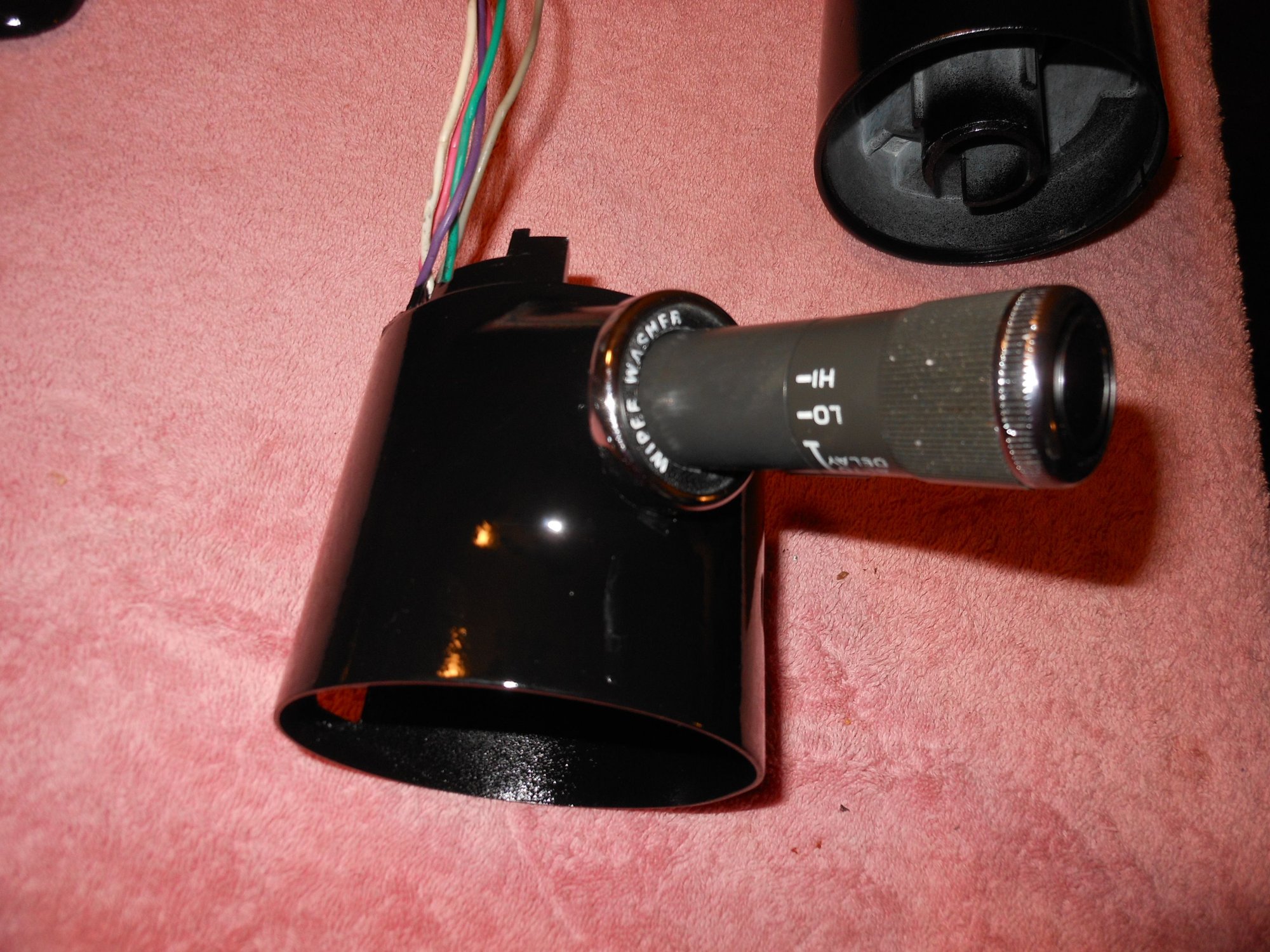

I took the original steering column- added electric power steering motor to it from a Nissan and Wiper & Controls from a mid 90's Caddy-
To C5 steering column in a C3 ??
