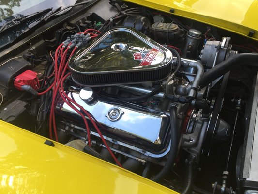

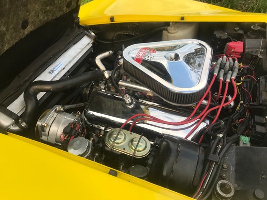

496 BBC, roller rockers, 3/4" taller than stock valve covers, March Performance serpentine with short water pump, Hooker sidepipes. ZERO clearance issues in my '75.
Originally ran tripower carbs under stock hook. Now running custom 3x2 EFI.

Full Comp Cams steel roller rockers with polylocks. Here are the valve covers:
https://www.cfrperformance.com/CHEVY...z-9504-t-c.htm
No problem clearing stock booster. Oil pan is a Milodon 31185. Great clearance for stroker cranks.
I am also using a Type 2 PS pump with remote reservoir. March makes kit for both types of pumps. All the pump required was a remote reservoir and extended hard line from pump to PS pressure hose (used '82 Corvette hose to get the metric O-ring at pump end).

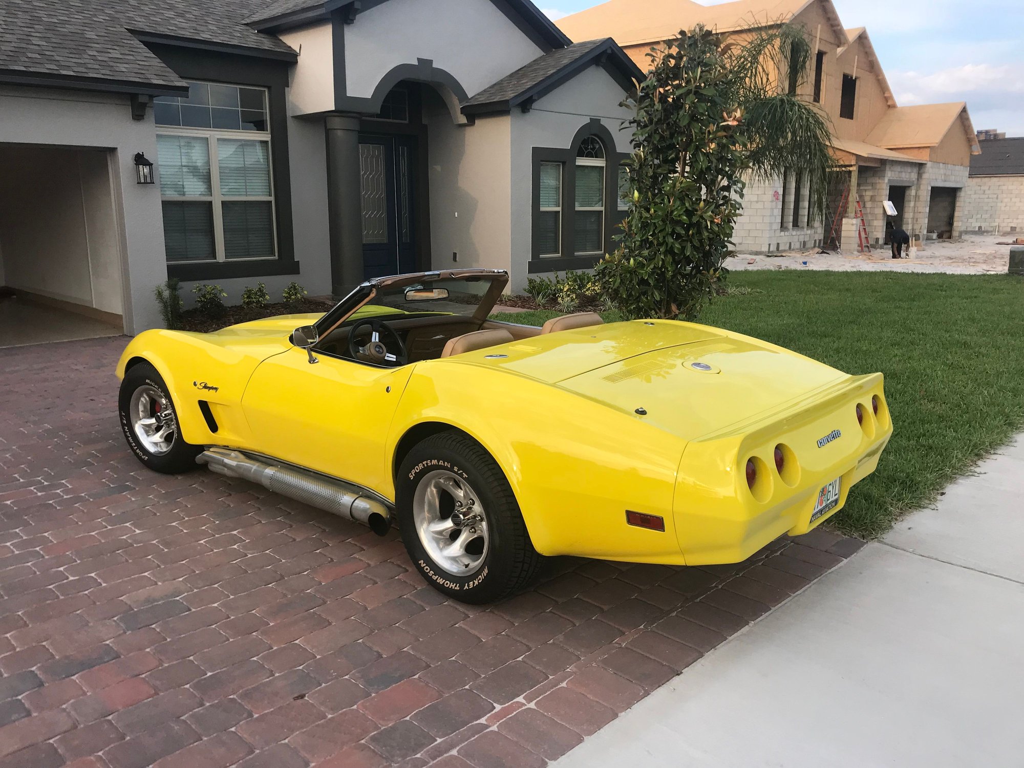

Running 550# front coils and custom 400# rear spring shortened 1/2" per side (before VBP closed shop). Bilstein shocks.
Rides great and you can see how it sits here:
