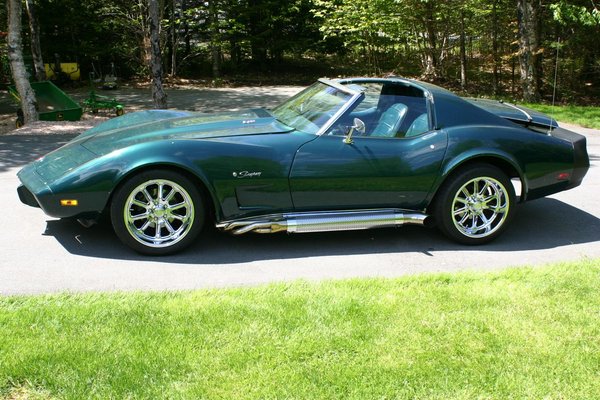

Old Oct 12, 2018 | 09:47 AM
resdoggie's Avatar
resdoggie
Had a 1976 L-82, 4-sp
Joined: Mar 2011
Posts: 5,338
Likes: 1,213
Royal Canadian Navy
US Mags Ramblers
