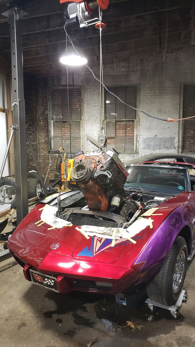

Gantry crane... end of story, one person operation
Same price as a high end cherry picker
Pulled tranny and engine together, totally cake
Harbor Freight 1 Ton Gantry Crane - $729.99
NAPA 2 Ton Cherry Picker - $199.99
I have both and the Harbor Freight Gantry Crane is the bomb, I lift both engines, frames and bodies.
Im talking about a heavy 6 ton, because i never leave cherry pickers stock ram length, i always extend them 2-4 foot on the jib cuz stock length doesnt clear much of anything, but i wouldnt dare do that on cheaper hoists. You end up with a ruined car and a mangled lift if your lucky, missing fingers or worse if your not.
btw the gantry with electric lift and trolleys, is more like 1100.00, and a good HD 6k cherry picker is about 900.00
