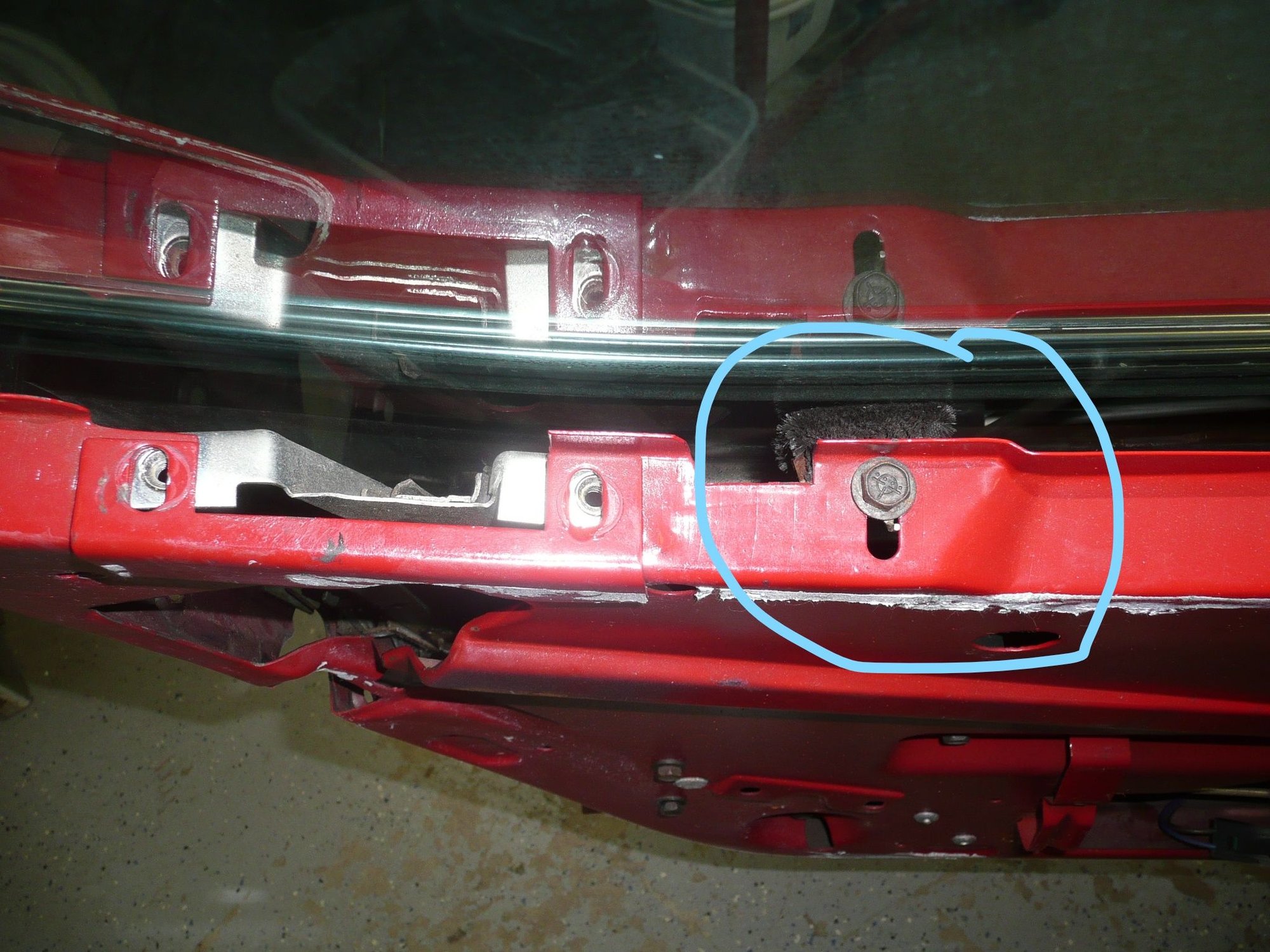

the left window on my 82 rattles when halfway down car rides a little bumpy
I’m not mechanically inclined any suggestions on stopping this will it cause any problems down the road
maybe need shocks

There's 2 adjustable carpeted bumpers at the top of the door. either yours are worn out or just need adjustment. You have to take the door panel off to adjust them.
