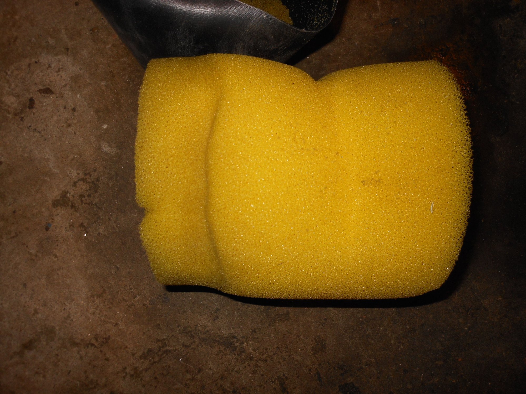

Here's what happened - 2 years premium -winter blend-
It ATE the expensive foam from my Aeromotive Stealth Phantom fuel system. It turned it to powder...
Brand new tank- you can see the results.
The guys at Aeromotive said they've seen gas even with Stabil do the same thing.
I won't use/store gas for over 6 months now...All my lawn tools- run them till they are out of gas.
