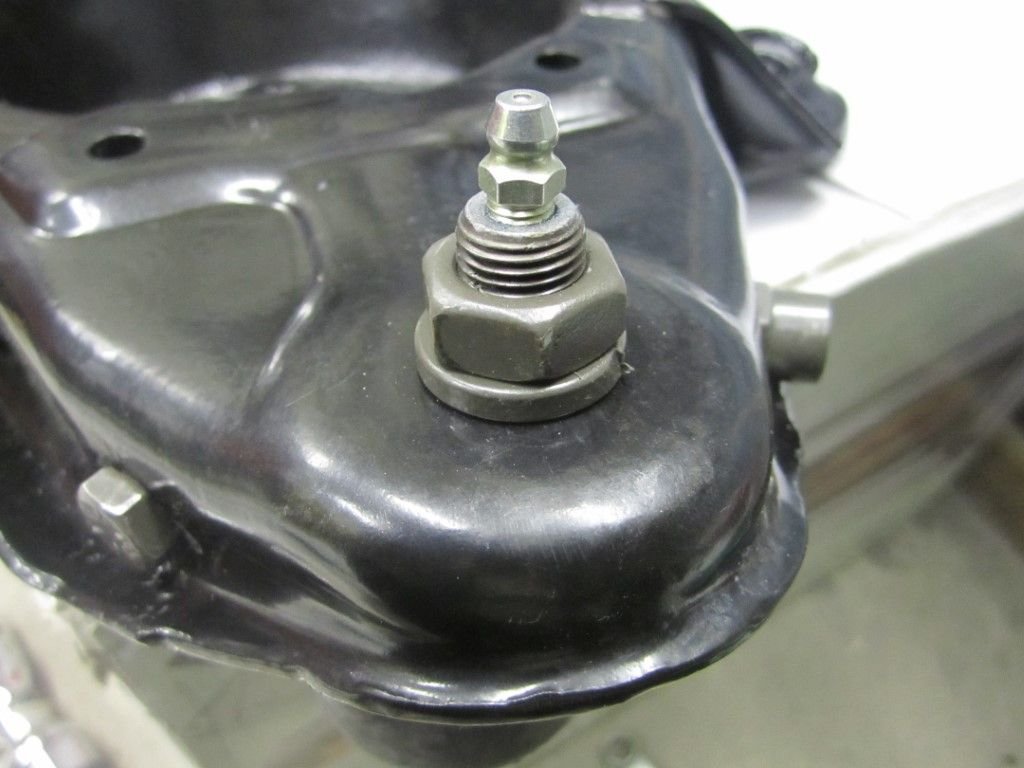

The rebuild kit has balljoints that are bolted to the A arms. Each lower balljoint has 1 bolt that is different than the other. The bolt head has a 3/8" stud/pin/shoulder.
Which side is this bolt used on or does it not matter ?

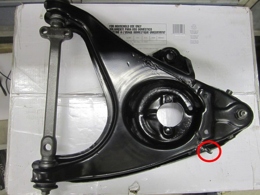

Doesn't matter.
Supplied as a turn stop but out arms have one welded on already (I put it on the front for whatever reason)

It goes on the front side.
