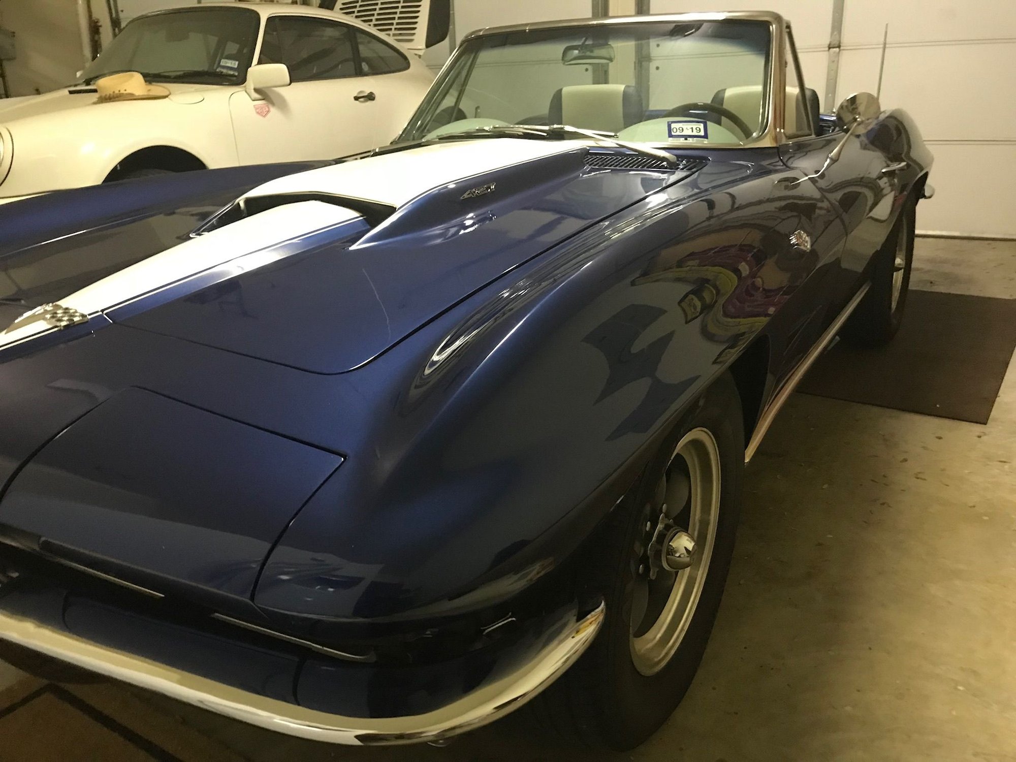

I know this is a C3 thread, but let’s give the OP some more pictures for motivation and I only have a C2 to offer.

You posted your c2 just to make me jealous..it worked...very sweet car.

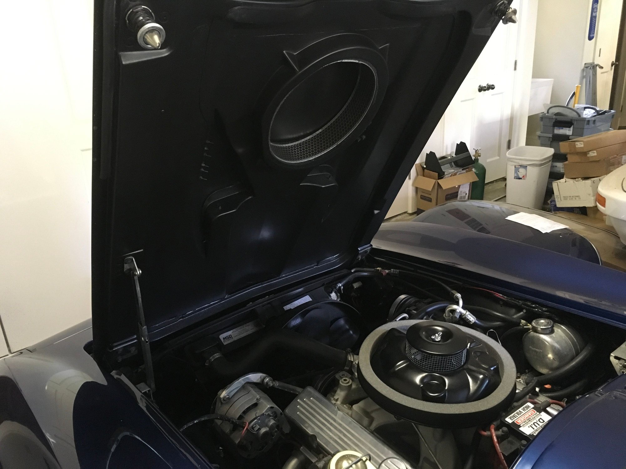

here is the one on my 76
