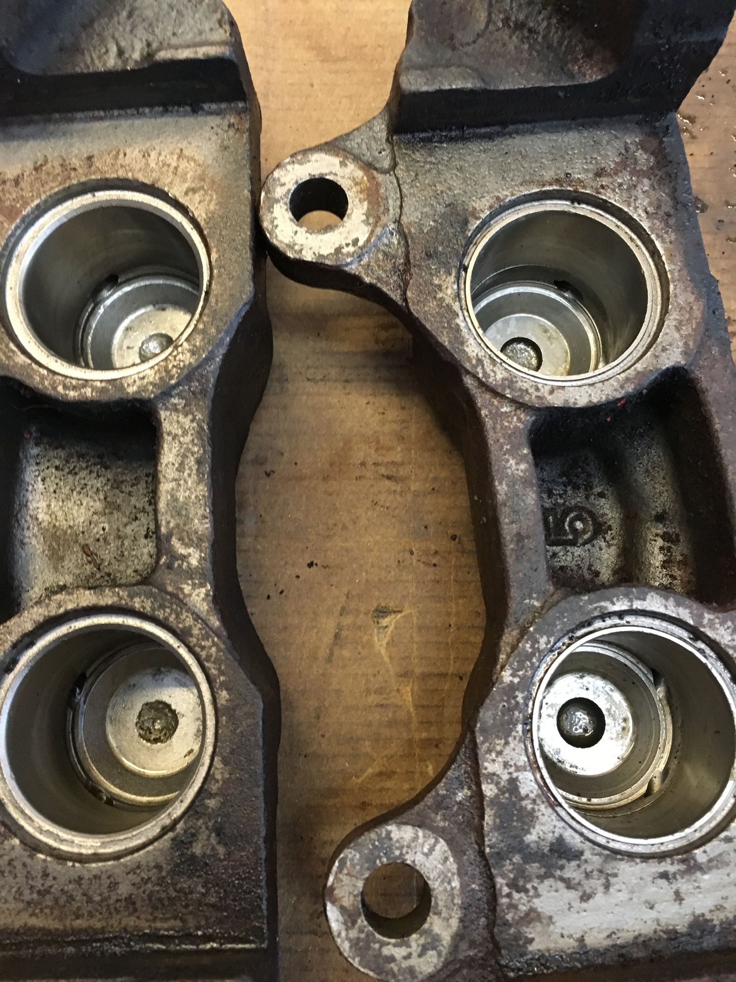

I don't want to push you away from a cost effective fix, but when I did mine I opted for purchasing new calipers. After I broke my calipers apart I found that one side was sleeved and one was not. As I understand (others correct me please) is that the O rings need to be installed on sleeved calipers. Maybe not but I think I read that somewhere. Food for thought for money vs time and aggravation!
Here's what mine looked like:
Good luck!

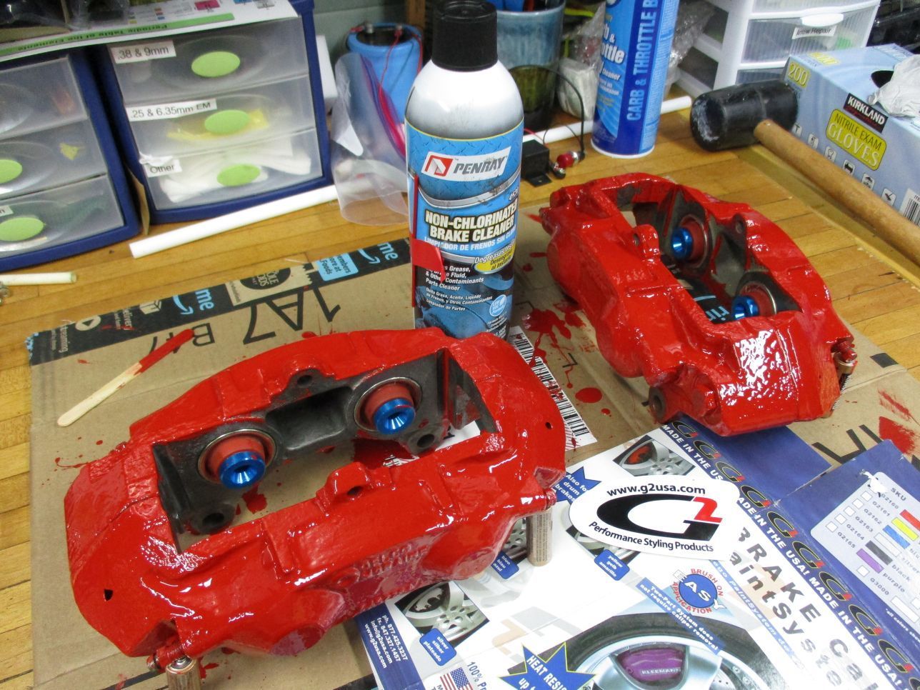

I just did my rears. I replaced lip seals in stainless-sleeved calipers with "high-heat" o-rings from CSSB Inc. The kit included pistons, springs, seals, valves, and a new pad bar bar in addition to o-rings. I painted them red at the same time with G2 epoxy, and bled them with DOT 4. It cost what it cost, but I got them just the way I wanted them.

In your photo the caliper on the right is sleeved correct? And the one on the left is not?
Mine are out of the vette and opened up, just trying to identify what the sleeve actually looks like.

In the caliper picture I posted, the half on the right side is sleeved. Notice the insert, the left side doesn't have it. I was surprised when I open them up to see that!

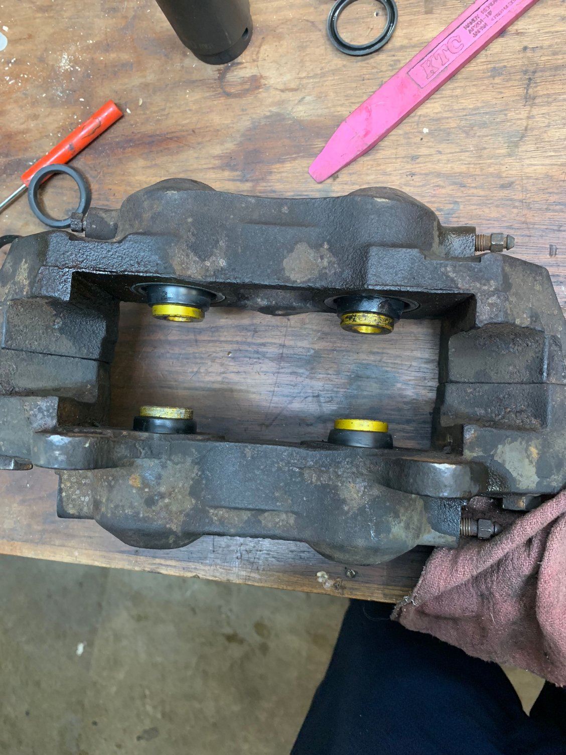

I use a plastic body panel tool. Pink tool in photo. Make sure the seal is seated in deeper portion of the pison groove or it will protrude too far.
I was surprised my rebuild isnt leaking.
Got home from work frustrated. Decided to blow off steam rebuilding a caliper. Gouged the sh*t out of one bores while pryng out the dust boot. Discover the kit did not come with a new small o ring for caliper half seal. Reuse flattened o ring. Discover pitting in one sleeve.
Feel like im probably wasting time and money. Install the caliper anyway. Bleed it quickly.
Test in the driveway no leaks. Around the block once no leaks. 5 mile road test no Leaks. I guess the gouges and pitting are both at different depths than current seal position. Hopefully my story gives you confidence to push the seals in just to see what happens. I told my experience mechanic friend about my botched rebuild mysteriously working well and he said “ if it dont drip dont trip”

I used a large wire wheel to clean up the caliper halves, then epoxied them (they are wet in the photo, it dried a bit smoother). Just stay away from the bores with the grinding and paint/epoxy.
