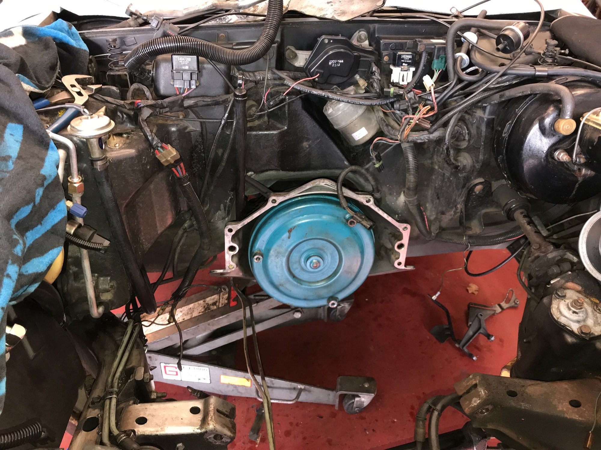

Just a quick update. I decided to replace the engine as opposed to rebuilding the existing. As noted above a car with high mileage like this probably would not benefit from any numbers matching engine.. my goal is simply to end up with a clean reliable car that I can enjoy driving to shows etc on weekends. So while the mechanic is swapping engine parts, I climbed into the empty engine bay to do some much needed cleaning. I plan to paint as much of the frame as I can reach, and get it looking halfway decent. The oil pan sump was full of metal sludge, another indicator of major engine wear. So I’ll post a few pictures as the project progresses.

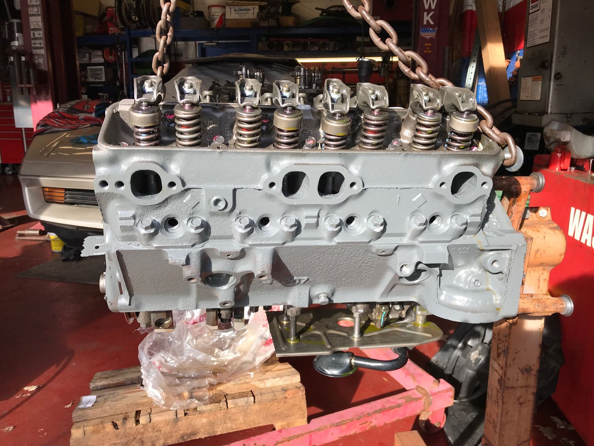

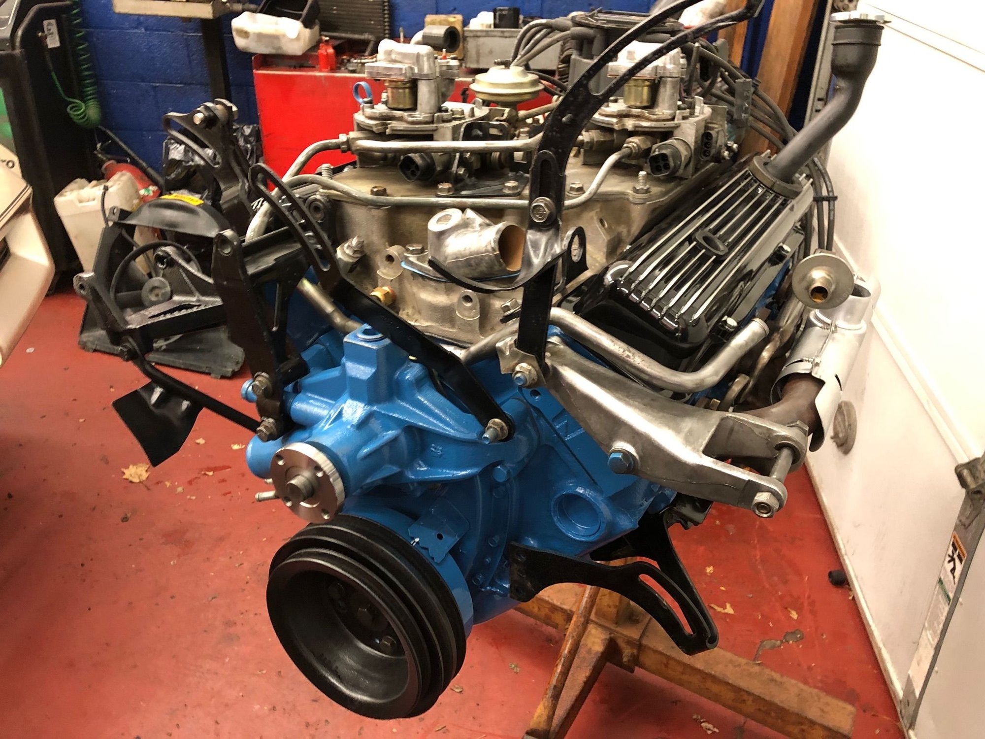

Just to bring closure to this thread, I bought a rebuilt engine core from Jasper, out of Indiana. The original core was sent back to Jasper. I did not request that the camshaft be exposed before the engine was shipped. It was pretty clear that the cam lobe was rounded out and this is the time period where a known problem of soft metal cams was identified. I don’t have the final bill yet but it will be slightly north of $5g, including the engine block. So along with the engine, the original matching numbers went too. I really don’t believe that the value of this car going forward will be affected by a non numbers matching engine. My kids can worry about that.
I took the time to jump into the empty engine bay and do some serious cleaning, sanding and painting. I don’t yet have the car back but it’s essentially complete and has been running. My mechanic is a stickler for detail and neatness. I found a crack in the exhaust manifold. That was repaired. New water pump, new engine mounts and new bolts in the key areas. Almost all of the rubber components had previously been replaced by me.
So the engine has been restored to its original Corp Blue and it really looks great. So that’s the story.
