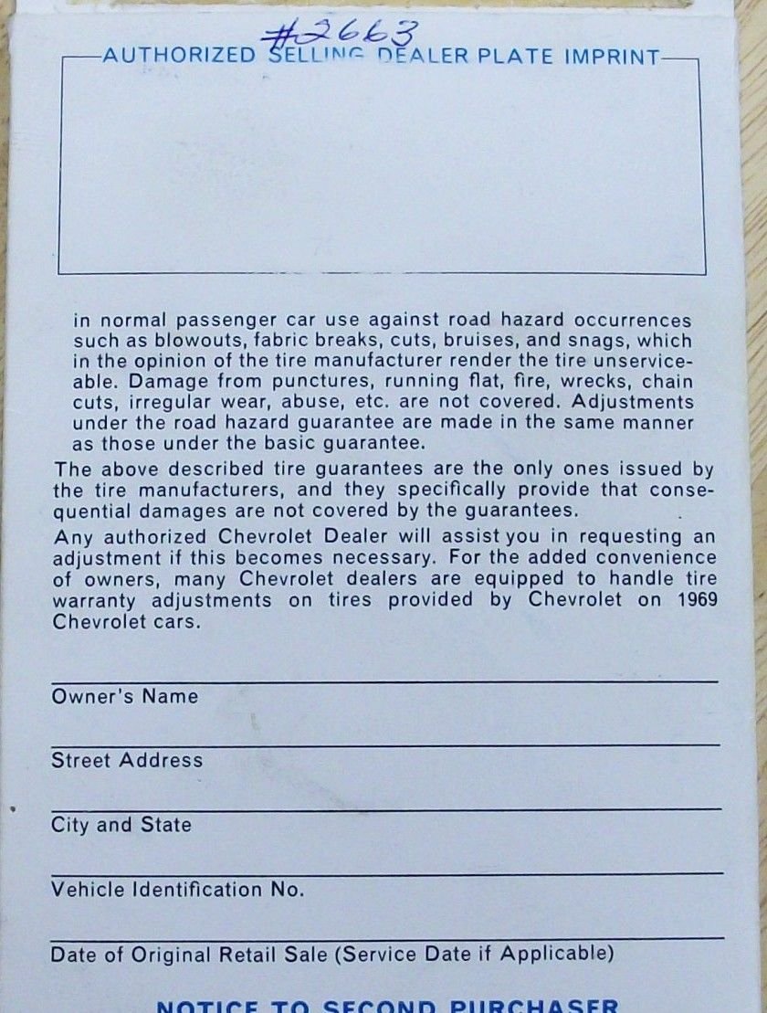

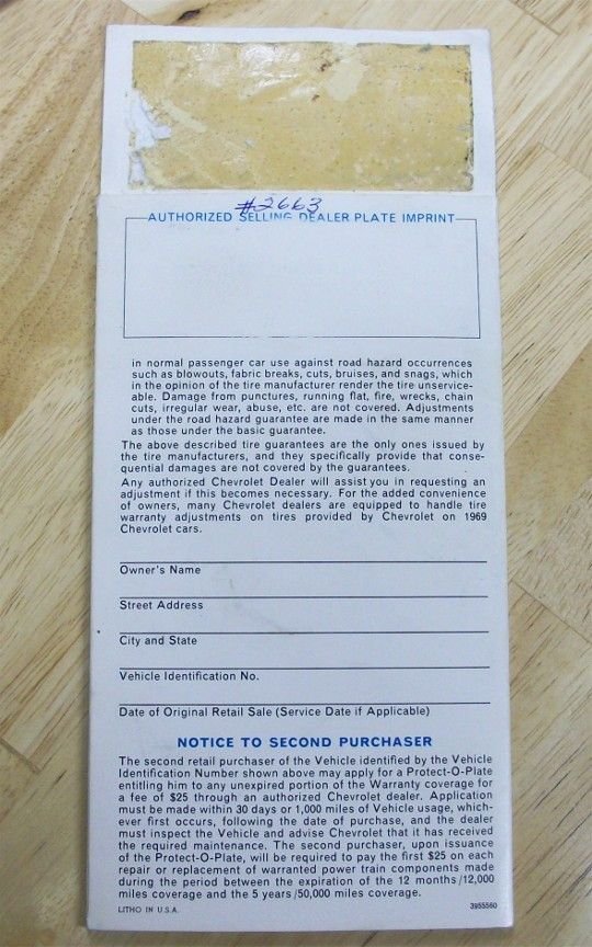

Oh man....
I hate to be the bearer of bad news but the pop is a repro, not original.
I have pictures of the actual paper manual when it was on ebay last year. I will post the pics in my next post when I retrieve them. I have pics of both sides. I recognized the number in ink over the dealer stamp area.
It looks really good and aged but good reproes are out there.
Hopefully your car is a real deal L71.
I wish people would come here first before they buy.....

Old Oct 27, 2018 | 11:34 PM
ed427vette's Avatar
ed427vette
Joined: Jul 2006
Posts: 3,103
Likes: 802
From: Massapequa Park NY
Here is a pic of the front
To protecto plate vs. diff. code
Old Oct 27, 2018 | 11:36 PM
ed427vette's Avatar
ed427vette
Joined: Jul 2006
Posts: 3,103
Likes: 802
Another pic of the back before the plate was attached and the new dealer stamp imprinted.

Originally Posted by toylman
Ed, I'm guessing you don't like the ones on the metal plate?
Yeah, the metal plate is no good...
However, if you look up the vin for this car I do believe this particular car is in fact a real 435hp convertible. Its red with a black interior and sold at some auction in July 2017. Even in the add it says it comes with no paperwork and the block was decked, however it was in completely unrestored condition and had lots of original parts. I think its real and probably has the original engine. But with a decked block it will be impossible to verify it beyond what you want to believe.
Still, a pretty nice car to restore.
