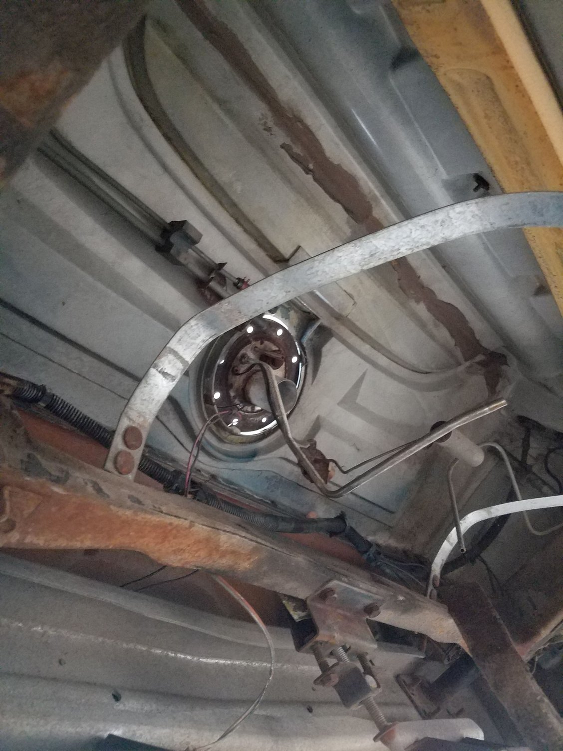

Yanked the gas tank out today. Didn't get a picture of the sock itself, but it was just about a solid mass and stained rust red. You could squeeze it and feel sediment inside. Replaced it, cleaned the sender unit, cleaned the inside of the tank (which still had the green sealant in great shape). The outside looked really good. I don't think the car has seen a lot of rain. There's nothing but the barest surface rust on anything I've come across on the gas tank or anywhere on the frame or on the rear end (that I got a good look at today) or the front end or anywhere else that I've seen. I shot some aluminum color rust inhibitant on the tank, particularly on the seams. Re-installed the tank and whatdaya know, the car can suck gas again with the mechanical pump.

Tank out, build tag intact.
Its really clean under there

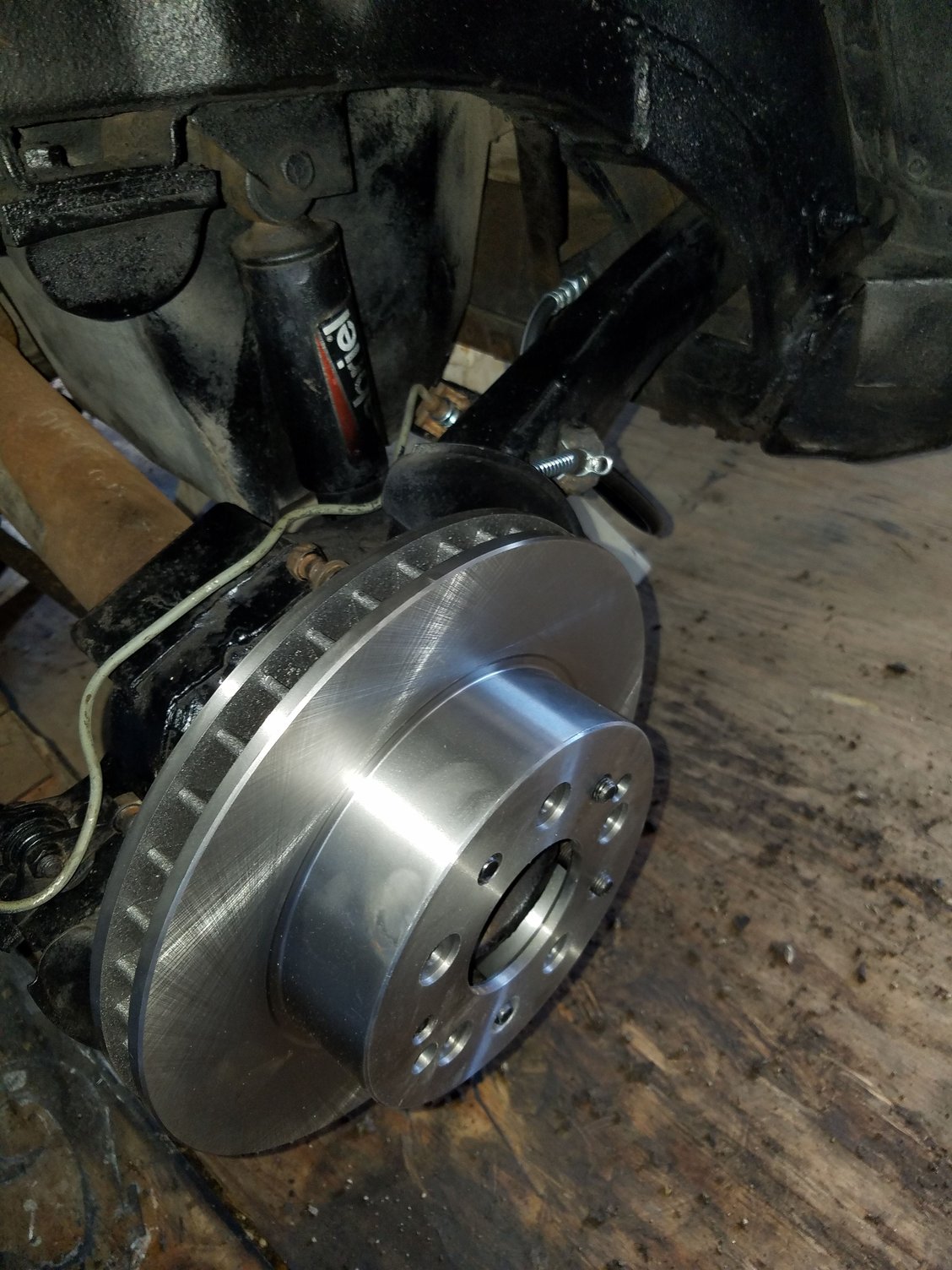

Redoing the brakes. Powdercoated and rebuilt the calipers. New bearings and seals up front. New rotors, pads, lines and e-brake cable. I have new e-brake shoes on order, but they're not in yet, so i couldn't finish the rear end. The front end has all new bushings. I have a kit to redo the rear end and some KYB shocks to put on.

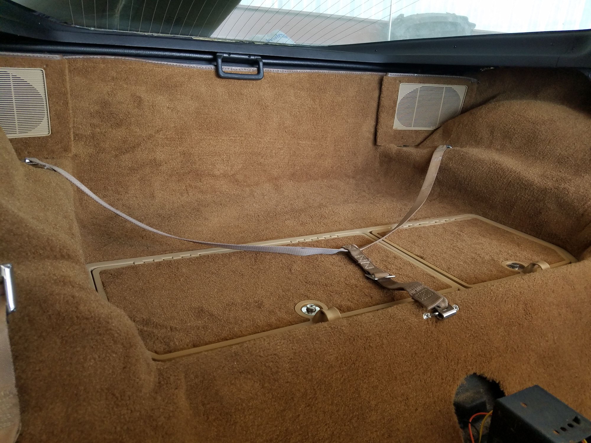

Worked inside. Got the rear carpet in, pulled all the halo trim and inner window surrounds and painted them. Speakers are in placed and wired. Its nice to see some tangible progress

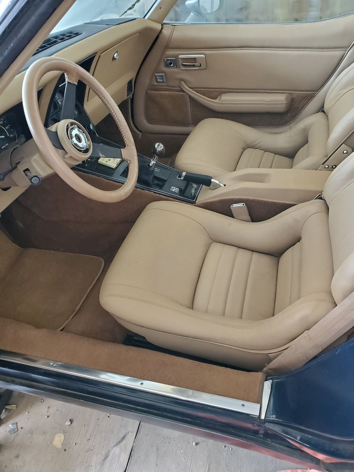

Getting this seat assembled. It was disassembled and in bags. I gotta say, neither seat is in horrible shape. The previous owner didn't beat the hell out of this car, and what was disassembled was tagged and bagged. A couple of tears on the seams on both driver's and passenger seats, but not lousy at all. I am waiting on another can of dye before i finish this seat.

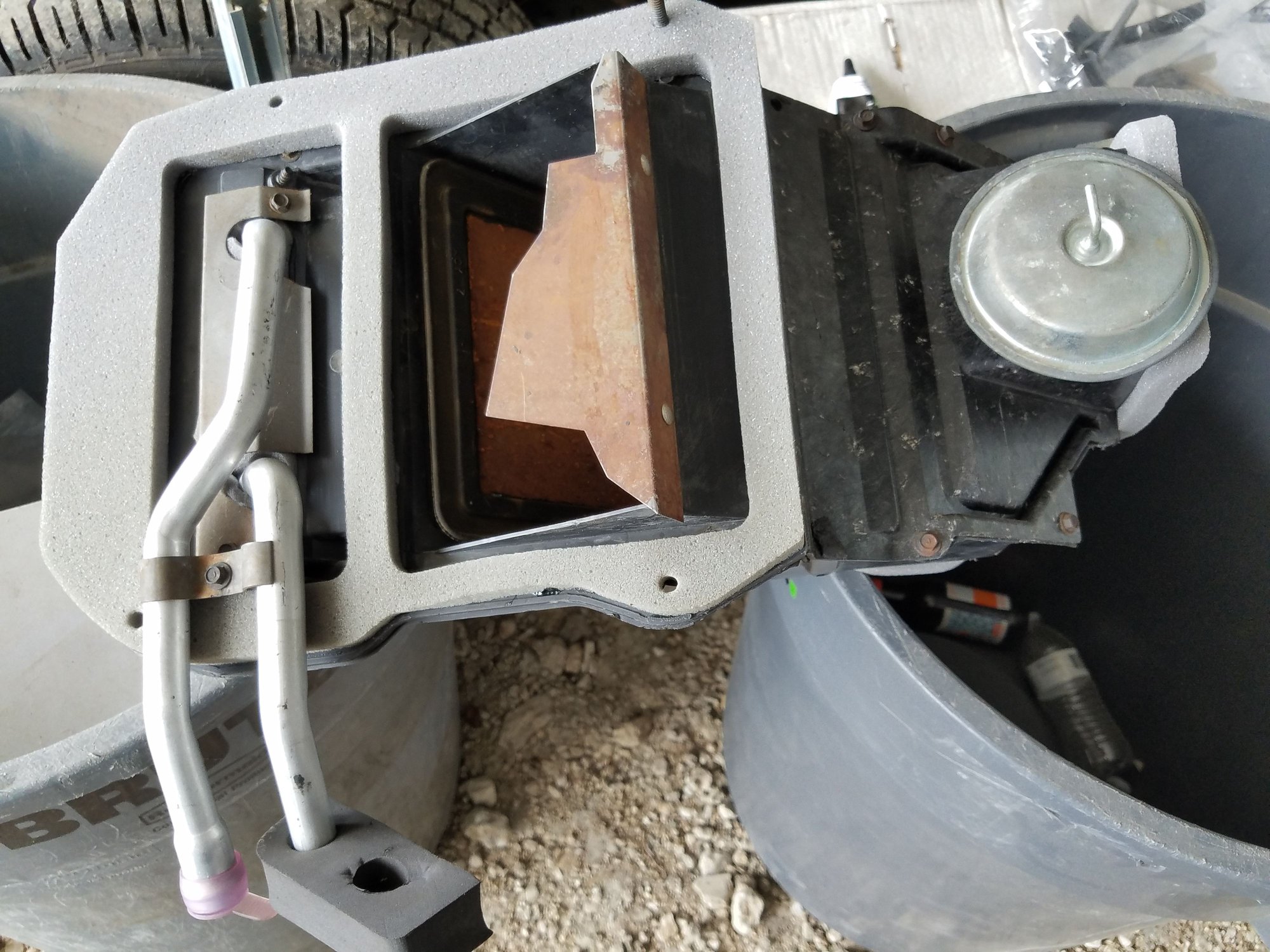

Default 1 rebuilt heater box
New heater core, new foam kit

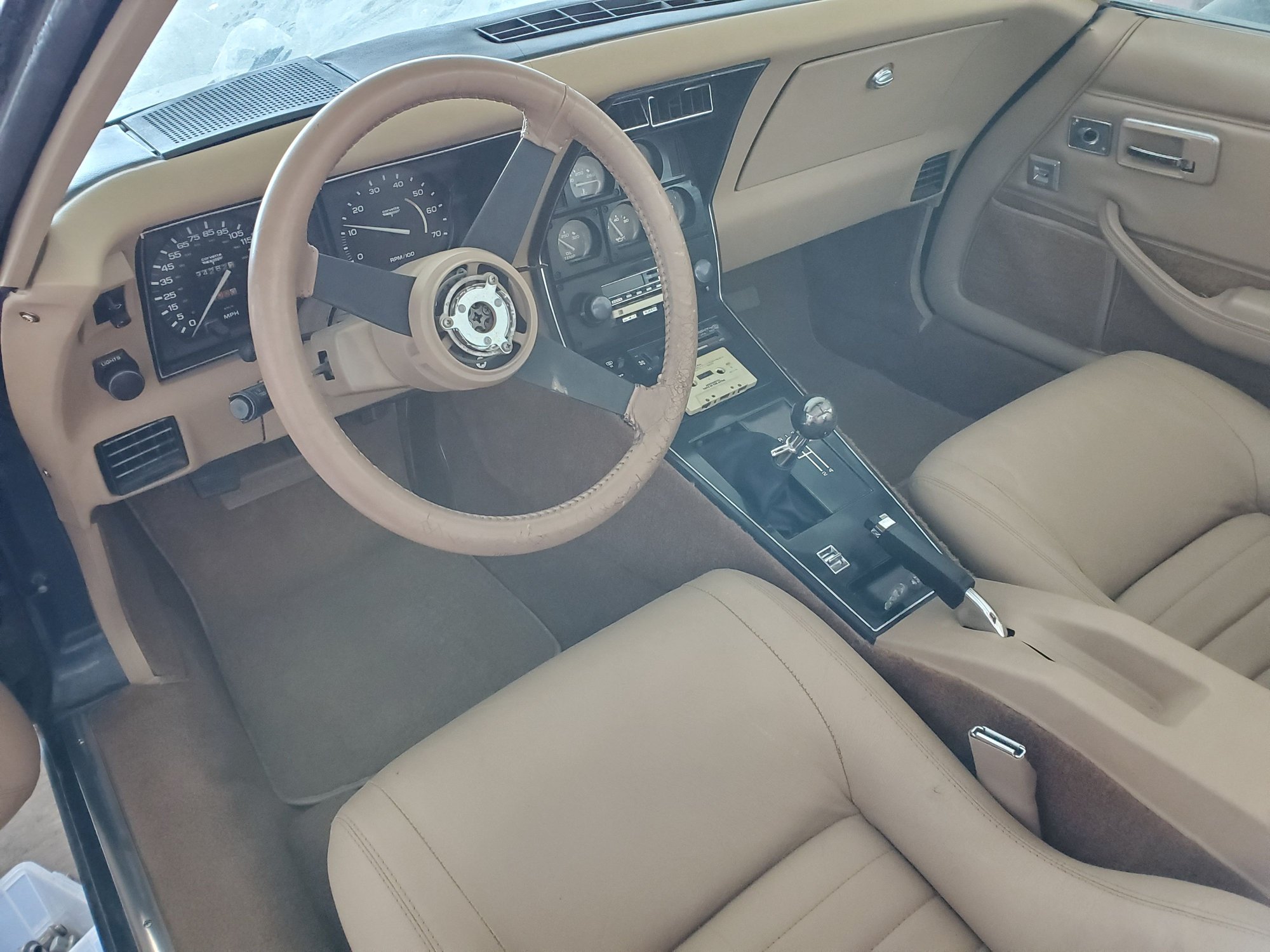

Interior close to done.

Kudos on a job well done. The new interior looks fantastic!
