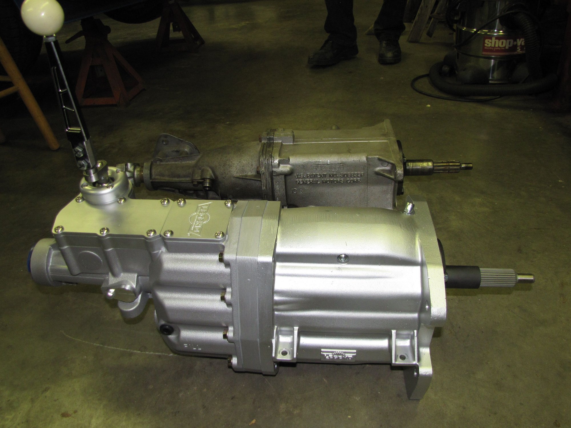

We put one of these behind a built 427 in a 68. Legend tranny and you can speed shift if. What a nice tranny. T

I just received my TKO-600 road race kit from SST that will sit behind a 496.
I researched several kits and they were actually cheaper in price than a couple of others.
The SST kit includes everything you need in their kit.
Most of the others I found were a "Base kit" and then you had to add everything else making the other kits actually more expensive.
No guess work with the SST kit and everything is there.
Their sales techs are very knowledgeable and will help you pick the trans best for you and your use of your car.
