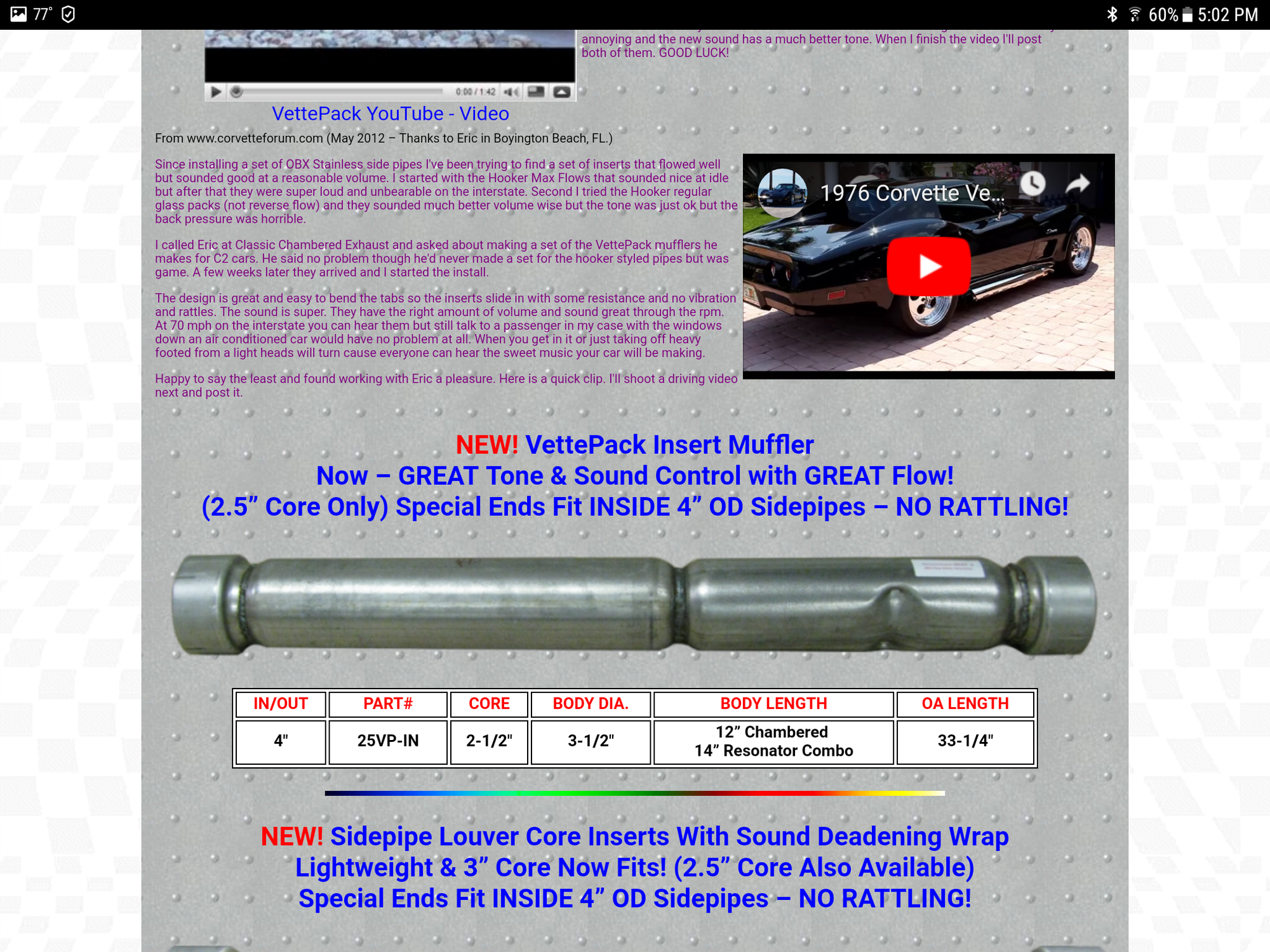

I use VettePacks in mine. Not too loud and they sound good.
http://www.classicchambered.com/classic/products.html

Thats what I was looking for, sounds (and looks) great. Thanks!!
