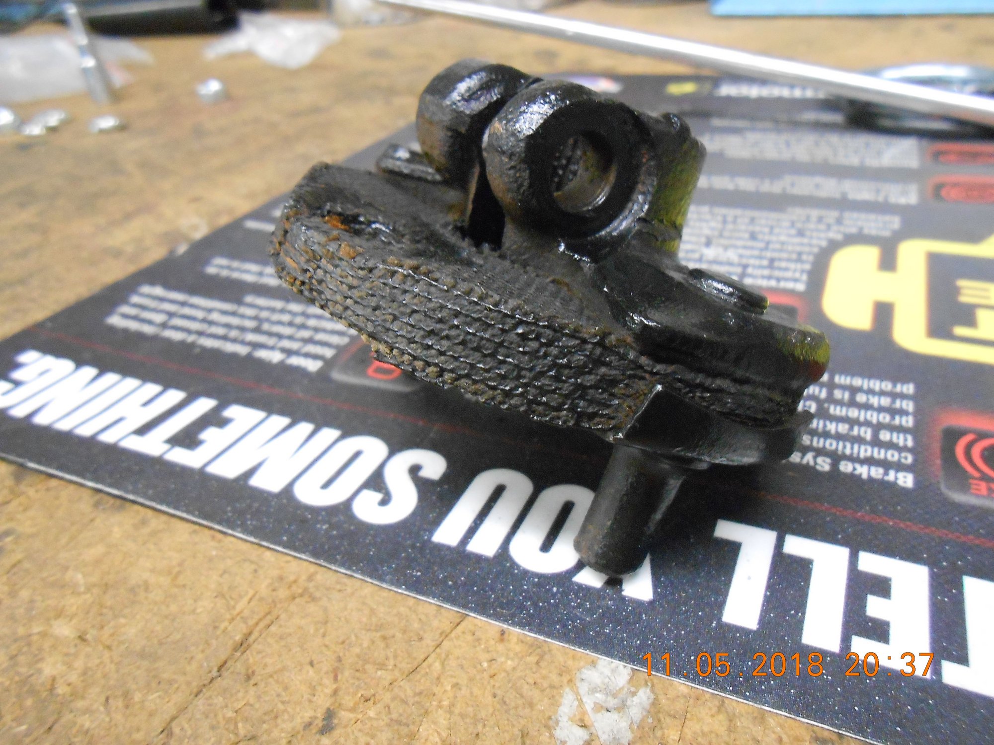

I purchased a steering coupler web repair kit. Does anyone know how you get the old web off the coupler. It looks to me to be pressed on. This is off a 1970 Corvette with power steering.

With the bolts removed it should just pull apart.

That looks good enough, to me anyway, to reuse.

The bolts won't come apart. Like I said it seems like they are not bolts and look like studs pressed in to each other. Maybe I need to grind the studs off to get it apart. Not sure what to do to get them apart.

It has two tears in the holes that the bolts go thru to bolt up to the column. Otherwise I would reuse it.

Yes the original type was held together with a pressed type rivet set_up(swaged ? ), the replacement "kits" usually have a bolt and lock nut type set up , usually just nylock nuts.

You can grind the pins flat where they are peened over and then punch them out. The rebuild kit I used had pins that had to be pressed into place and then peened over.
Thats one of the jobs the rounded end of a ball peen hammer is used for.

They also offer a 'complete' coupler pretty cheap that can simply be bolted in rather than 'rebuilding' the original. As I recall those 2 studs are pretty well pressed in there. The new ones have a rubber joint with a metal mesh for electrical conductivity which actually seems to work pretty well. The old ones like yours has a thin copper shunt that connects across the studs - mine never provided great continuity for me.
