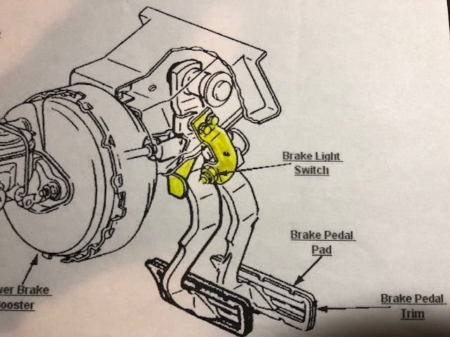

Heres a beer pic of the assembly with the 2 parts you need highlighted....it shouldn't be problem yo drill a hole thru the brake pedal lever to mount the striker plate....or you could just epoxy it in place if ur not comfortable drilling the arm....
These parts should be available out there, its just getting up in there and doing things by feel to get it installed. If you don't have the mounting points for the bracket then just do what i did....there is a bolt up there you can attach the bracket to, u just have to bend say a 3" piece of flat steel and drill hole for the switch. Keep in mind also that mine is a non power brake car so ur mileage and options may differ!
