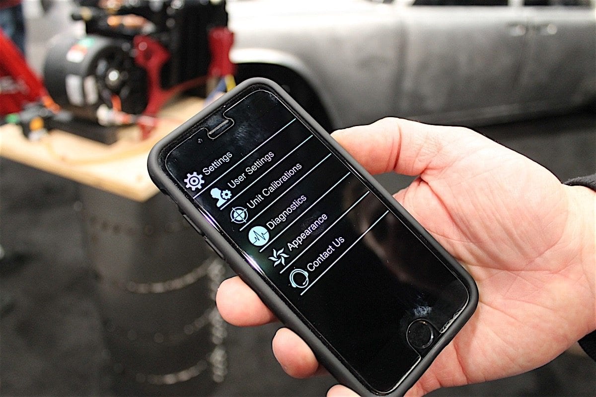

You can set it up and control it from your phone...Only problem is my state just passed a law you can't use your phone while driving...So I'd have to pull over to adjust it!!!
