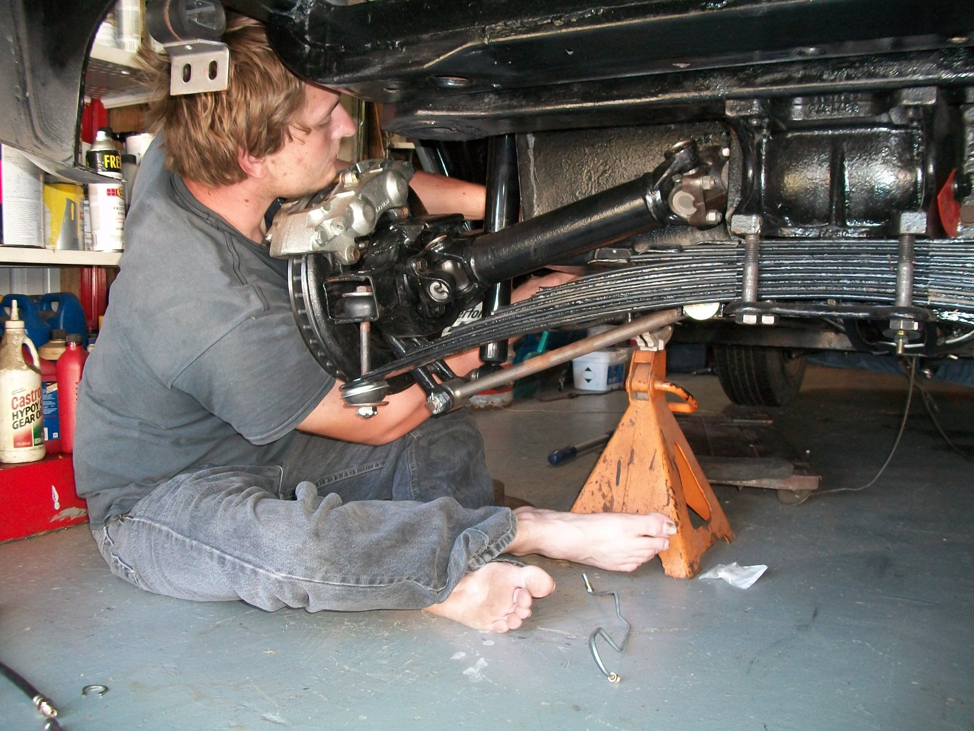

We also used long needle nose pliers, and forceps. But the EASIEST way I found was to get my youngest son to do most of the work!
