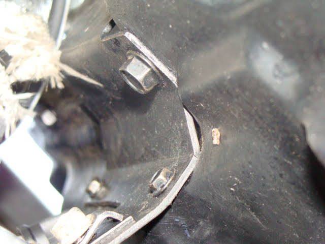

Originally Posted by kanvasman
try from under the car. There is a small dust shield that is held in place by 3 or 4 bolts. Take it off and everything is right there in front of you. Then you might get the leverage you need to break it loose.
That and take the grille off of the fender. You can bring another hand in from a different direction.
The top nut is what got me. I had to fabricate a wrench to get in there.
The screws mentioned by kanvasman....
Craig
Here are the three screws that kanvasman mentioned...
