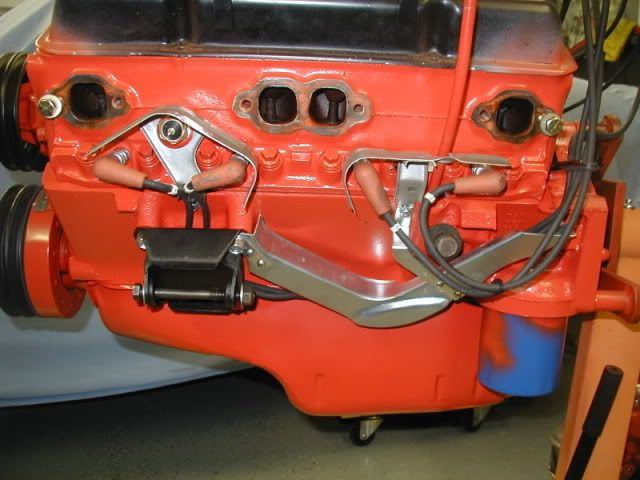

Not sure what year you have, but on my '70 I ran wires under the headers also, using the original shields that mount to the block. Works very well. They look just like the shields shown here, but I don't use the portion above the boots. I found this image online:
x2
this is how I did mine, cut to length as well... first time going under the headers and I LOVE it
my heads are angle plug, and talk about MASSIVE amounts of room away from the primaries and NO chance of burning them this way like what CRF311 said.
