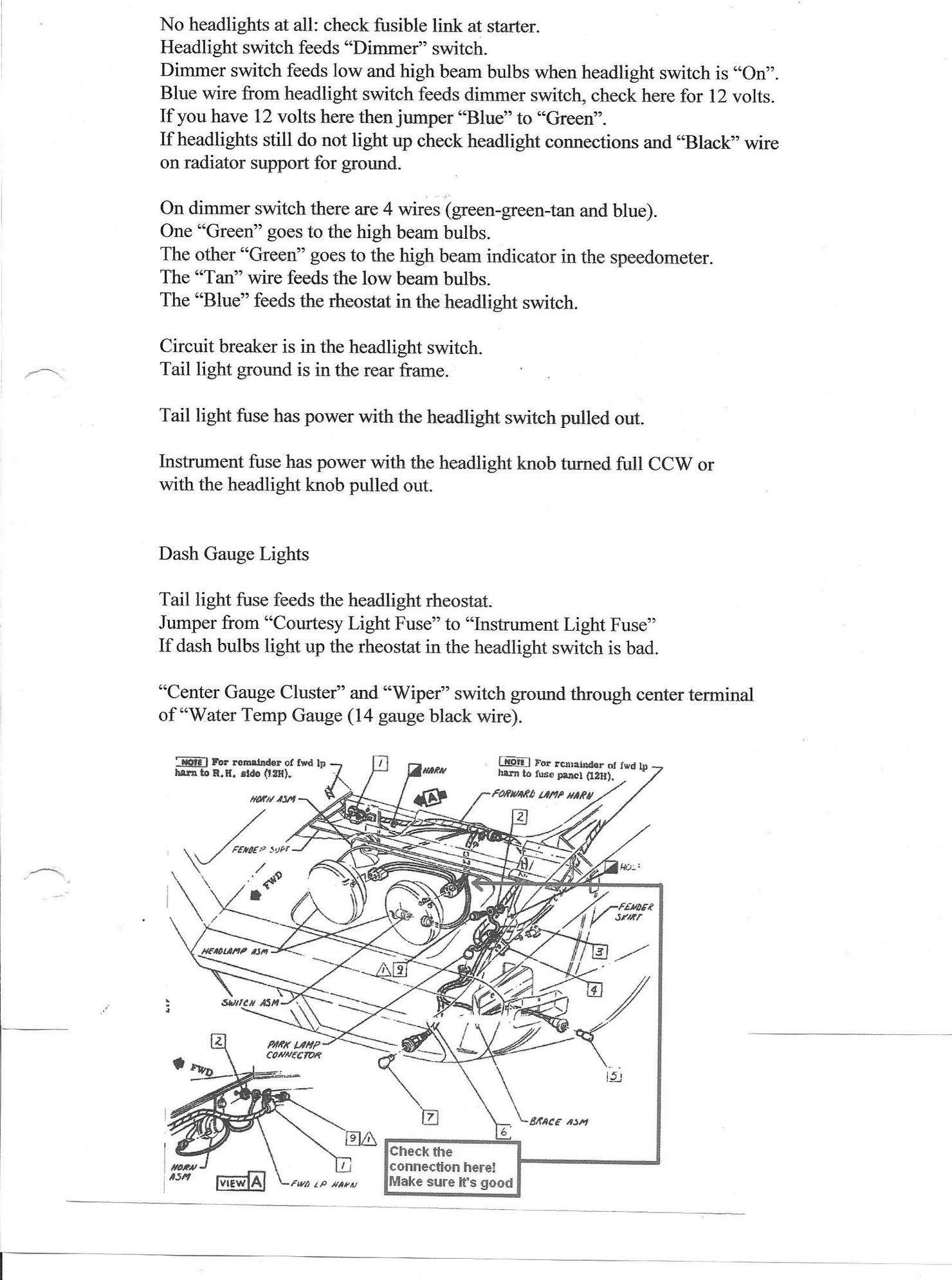

This test won't cost you anything and might help you to pinpoint the problem:
Old Dec 27, 2018 | 09:05 AM
20round's Avatar
20round
Joined: Apr 2014
Posts: 1,766
Likes: 78
From: montague michigan
C2 of Year Finalist (stock) 2019
nicely done!!!! i am saving that!

Soo.. I suspect the problem has been correctly identified.. thanks for the steer gents!
next question.. where can I obtain a new plug? I can probably get it running again just swapping out the dimmer switch, but I'm not sure that plug is fit for purpose much longer

I've now found the part... but note that it only comes with 3 wires, one for each terminal...
I think those 2 green wires both go into the same terminal? Is that right? So I can splice them into one connection when I join them to a new plug pigtail?
thanks for confirmation!
