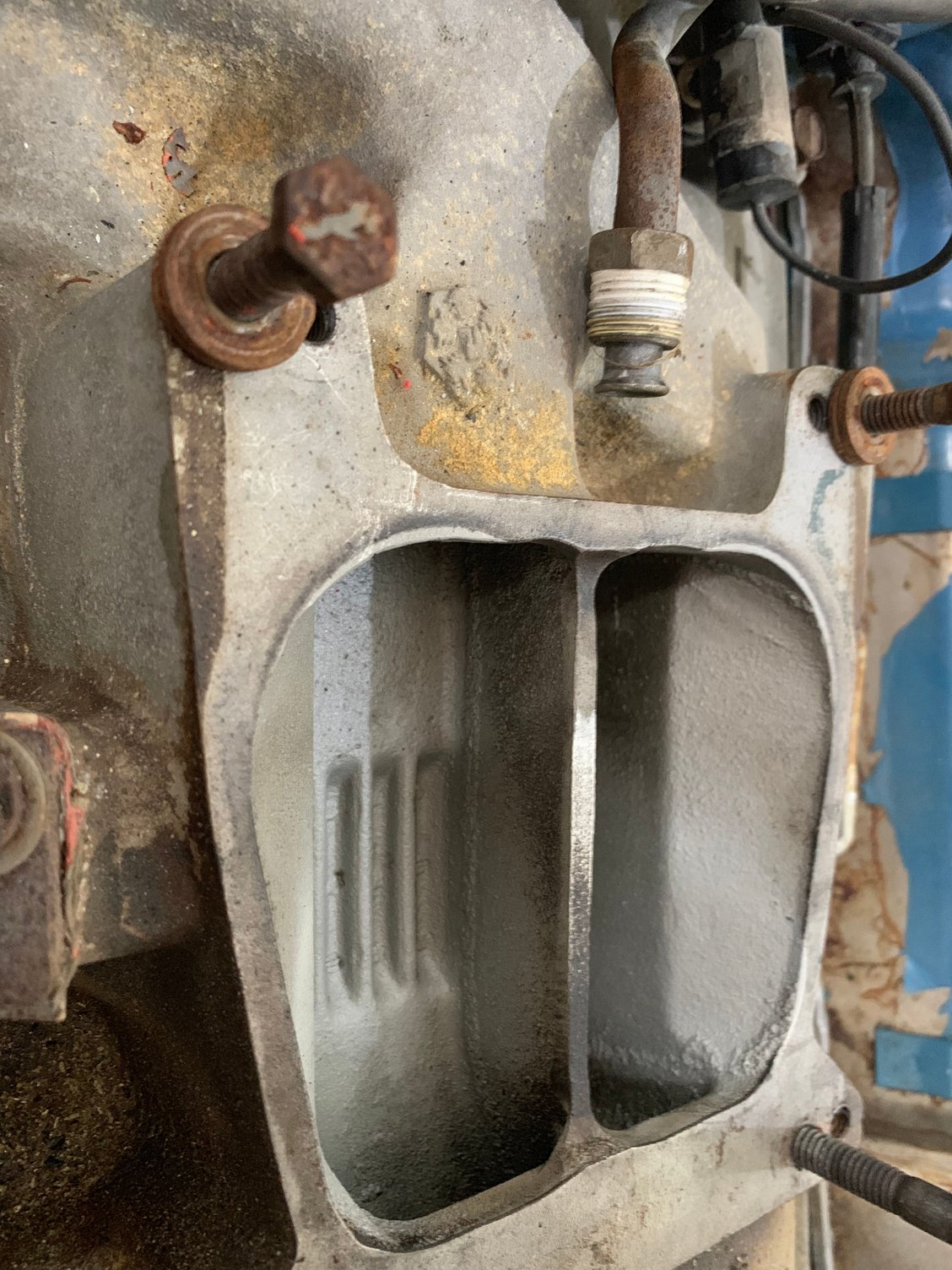

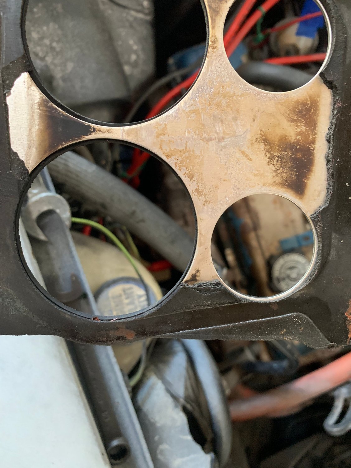

I pulled my carb to replace the secondary butterfly tensioner spring on my new to me 79 with a 400 small block. The intake baffled me a bit as you can see the divider in the center of the intake has a bit of a valley in it. Not knowing my way around the vettes very well yet I am not sure if this configuration with a quadrajet is ok; I would sincerely appreciate everyone's help. Also attached is a picture of the gasket which concerned me as well. No telling if the previous owner installed it beat up like that or if it crumbled off in this engine or the engine the carb came from.

Well, since no one wants to answer, my $.02.
That does look like the q-jet gasket on my '69, but the manifold is way different. Mine matches the gasket.
Replacement carb or manifold?
The Edelbrock below does not have a cut down devider.

I suspect the intake in OPs pic is from OE L82 ... it's aluminum and it has the "snowflake" marking it as manufactured by Winters. I do Not know it the cutdown divider is OE or not.
Under the coolant hose is the Holley logo as well. Curious is Winters and Holley had a relationship. My vette did come with an L48 but the guy I bought it from said the guy he bought it from bought it as a project car. Lord knows what has been done to this poor thing

Factory manifolds usually did not have the recess in the manifold.
Some manifolds had the recess. It was supposed to equalize the return pulses from the manifold and thus get a more " true" signal to the carb = thus feed the engine more accurately. .more uniform mixture...
Most people used an open manifold to carb gasket when the manifold had a recess. No center runner on the gasket.
I did it when I raced and street drove the car... helped a lot

must not be L82 intake ...maybe cast by Winters for Holley

I would use the regular GM spread bore gasket but cut out the center runner as it just "flops" in the wind.
Put the gasket on the manifold and use a Sharpe to mark it .
Use a sharp x-acto knife and slowly cut tit .
The square bore gasket will hit the larger secondary's .
The cut gives the dual plane some of the advantages of the single plane, but retains the desired street manors.

TinCanSailor, it would be useful to see a full picture of your intake manifold. It does however resemble an unmodified Holley Contender manifold.
I would follow BLUE1972's guidance and reinstall everything if you are otherwise happy with the carb and manifold you have.

Thank you BLUE1972 and my sincerest gratitude to everyone else that contributed. I bought a new gasket and cut it down as suggested. My secondary butterfly tensioner is in and took the car out for a nice drive today. No more stumble on tip in and was it nice to feel it take off. My next effort will be focused on getting it to idle down.

Get or cut down a q-jet gasket to perimeter only. Middle of the gasket is unsupported and flaps around til everything but the metal core breaks off and goes out the exhaust. Yet the perimeter was still intact and sealing.
