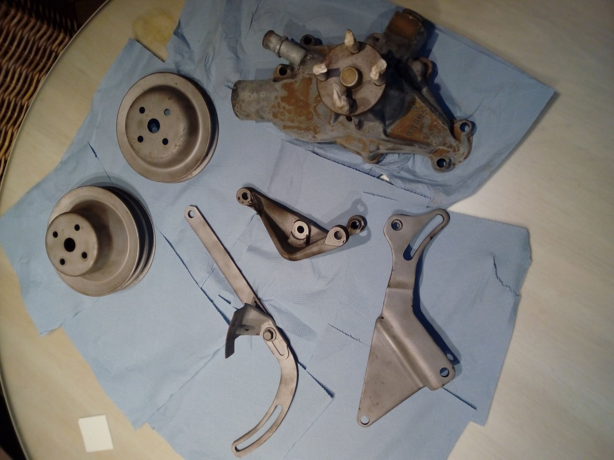

I sandblasted al the brackets, fan, … etc. All these parts are now ready to be prepped and painted.
I will use VHT high temp primer (engine enamel prep) and after that VHT ‘GM satin black’ engine enamel. (apart from the water pump that has to be Chevy orange).
The product discription says that after the paint is completely air dried, it must be cured to substantially increase the durability of the finish. It has tob e baked at 200 F for 1 hour…
No one I know will let me bake engine parts in the kitchen oven (nasty chemicals etc.).
How do you guys cure/bake painted (‘ceramic-ish’) parts?
PS: Don't mind the brown stuff on the waterpump. It's a self-etching primer.
