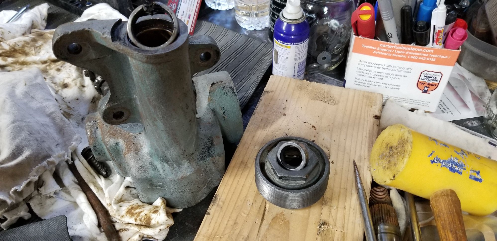

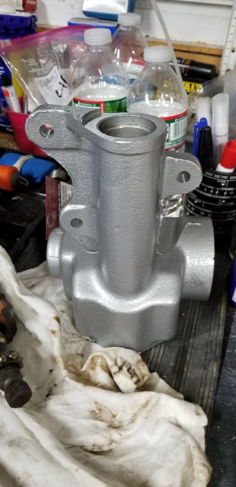

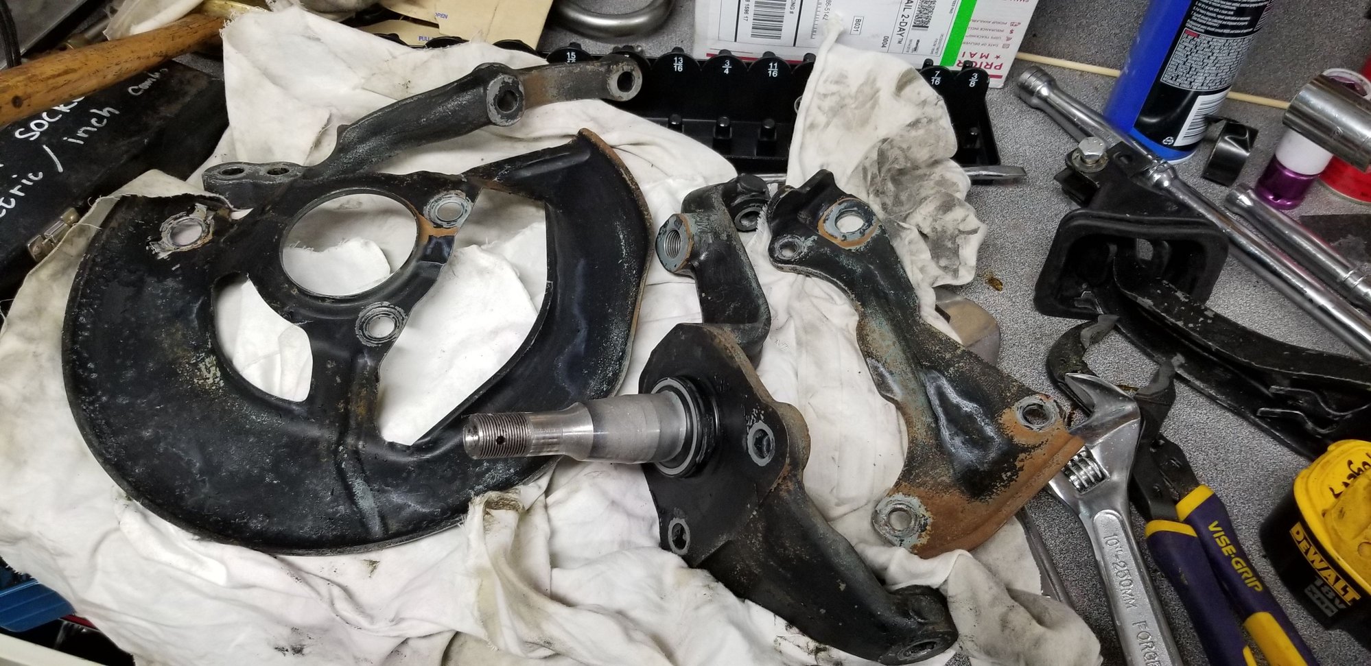

So a week or so back I find a harbor freight 20 gallon parts washer for $40 bucks. Well thats a great deal and I have a bunch of parts I want to clean and paint so I buy it and drag it home. Well the instructions say the pump is to only be used with a biodegradable solvents and the previous owner said he used Purple Power which I had seen at Walmart. I remembered the label said not to use it on painted surfaces or aluminum so I avoided it. Wellllllll...... So I go back to Wallyworld and buy all the gallons they have at the local store and then I run to another store to get the total of 12 gallons the the tub holds. Its only $4.87 a gallon and the warnings make it sound good. I mention my new adventure to my buddy John and he said he used it before and it worked good. So I think to myself, I'm on the right track.
Welllllll... I fill the tank, dunk in my parts and it cleans the grease off the steering knuckle pretty good. So while I'm cleaningand scrubbng that, I tossed in my steering box and let it sit overnight while I try to scrub the paint off the steering knuckle. The next day I pull out the steering box and I can wipe the paint off of it!!! HOLEEE CRAP!!! I cant believe how good it cleaned up. I can wipe the paint off with a rag, so I scrub what I can just to make sure the tough stuff comes off and wipe up the rest. So I throw the knuckle back in since the box cleaned up so well and let it sit for a couple of days. Just using the little pump, the fluid was peeling the paint off the parts. Again I'm happy as a clam in New England Chowdahhh!
So I dont know if it will degrade aluminum, but it eats paint. Heres some pics to keep everyone happy.

Its alot easier than my blast cabinet and I dont have to worry about bearing surfaces. Now i can just toss them into the cabinet to clean up the rust,. easy enough to see the rust now
