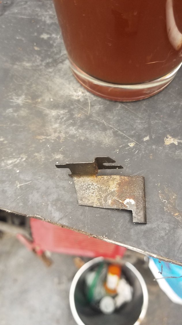

Hello I'm trying to put back to dimmer switch actuator and I noticed the metal retainer clip fell out does anybody know where that goes thanks here's a picture

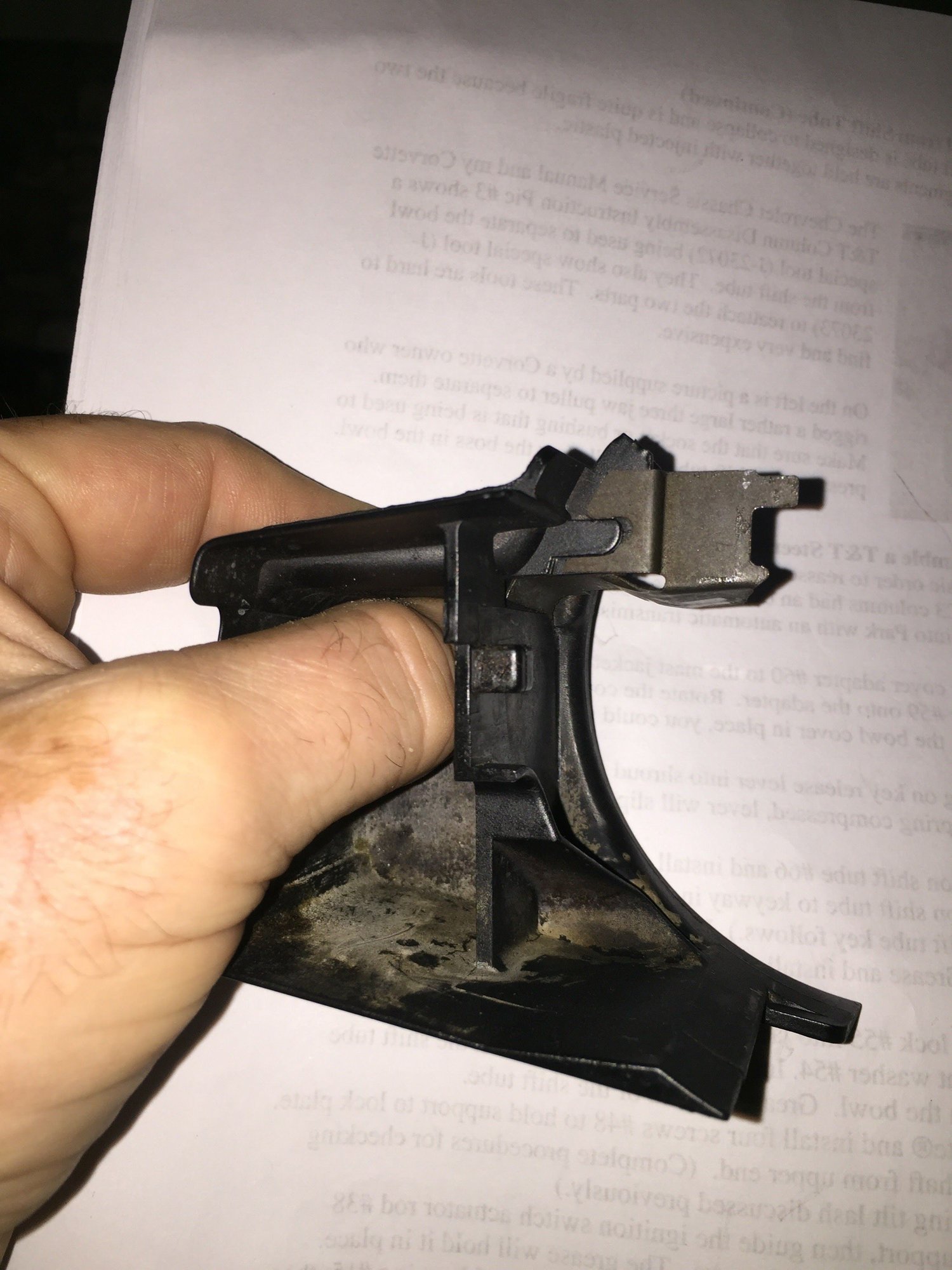

It goes by the tilt lever. It's some type of shield. Here is a picture of mine when I rebuilt it.

Thanks wow!
I think you're the only person in the world who knows where this went 🐴

just making sure when I put that little box back on at the dimmer actuator is greased into that little square nipple inside the box cover rather than putting it next to the metal rod inside first I hope I do this right cuz I want the dimmer switch to work
