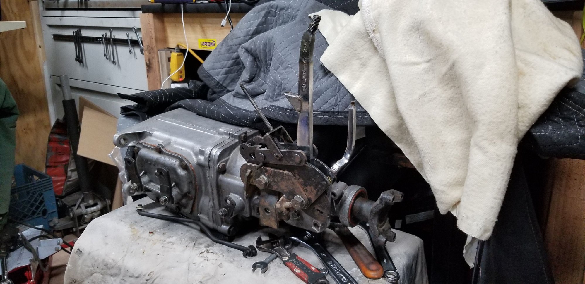

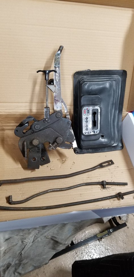

Update.
I go the shifter and rebuilt it buying a few new parts and replacing the Mr Gasket lever with a new hurst one. It came out nice and is reasonbly tight. I just have to add a new bronze shim inot the reverse path to take out that side to side slop.
how she arrived with ratty rods from God knows what application
bolting it to the Muncie. I came with the correct mount for the Muncie for a Corvette
after replacing the Mr Gasket shift lever with the correct Hurst lever. After this pic was taken, I added a spacer to lengthen the 1-2 lock out finger lever and received and insstalled the stand off guide for the same lever
