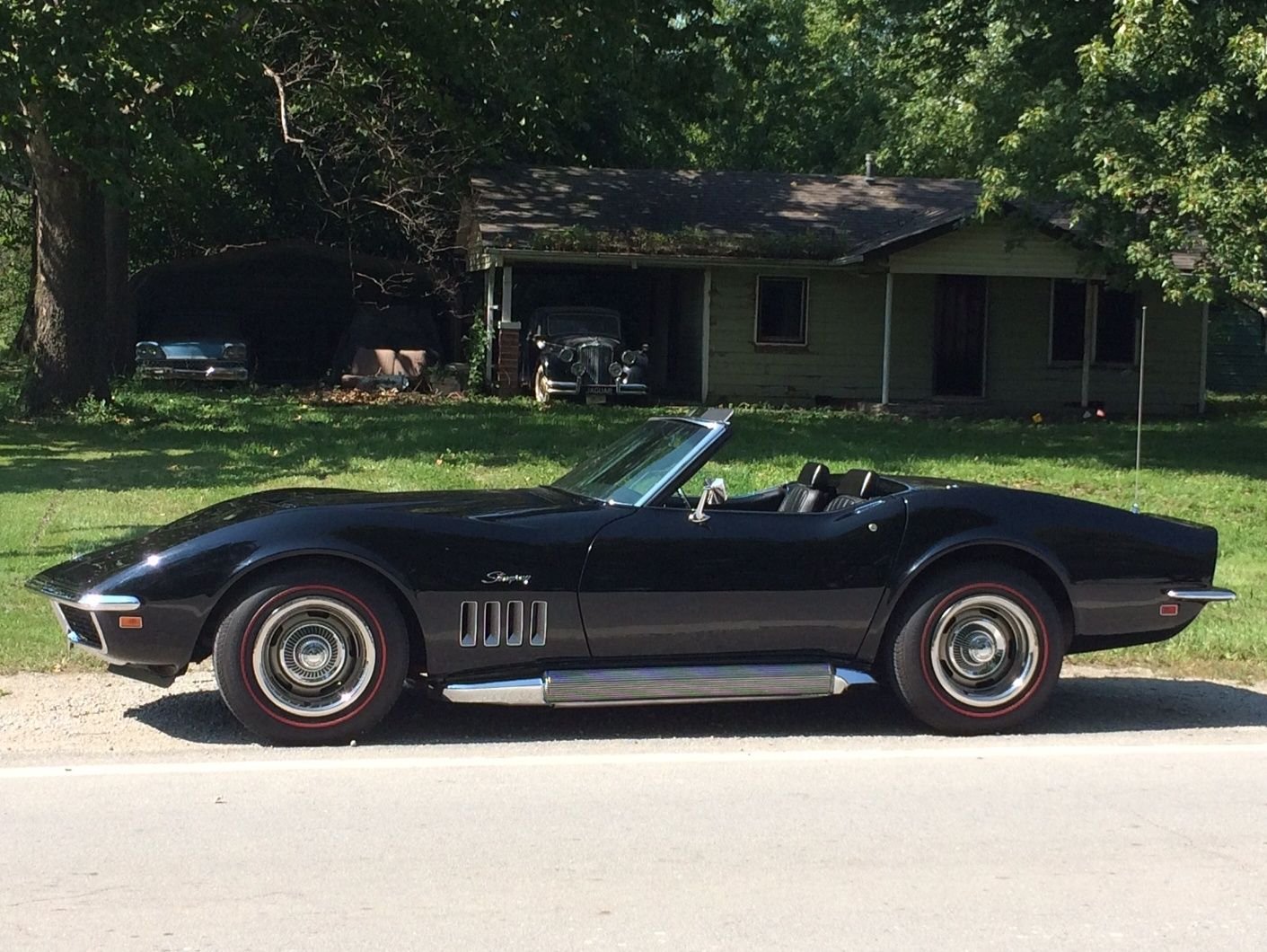

My car is a 72 4-speed small block convertible also. Just had a brand new set of Paragon's installed a few months ago. Yes, I can here the radio, and talk with my wife. But in all honesty, I wish mine were one notch quieter...

A friend of mine has the Paragon "quiet" side exhaust on his factory BB 66.. It's the PERFECT sound in my book. When I was on the phone with Paragon to order my exhaust for my 72. I asked if I could order a set of "quiet" in the 69 style? I was told NO such thing at this time.
I'm not new to side exhaust. I wore out a factory pair that were on my car for almost 35 years. I figured the new ones would be much quieter then my old rotted out ones.. They are,a bit, but not as much as I would have thought. As you said, local driving is fine and fun.
The way my new ones sound now. It would defiantly make a long distance drive like the RT 66 trip we have in the planning stage a bit less enjoyable I'm thinking...…?.
