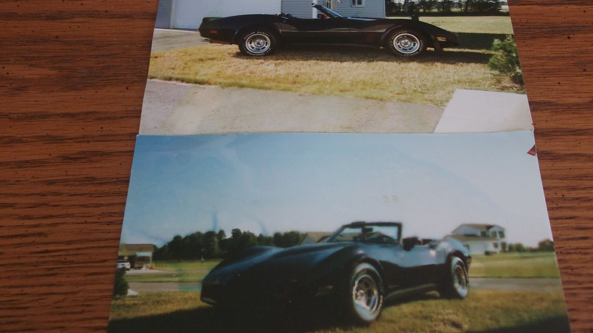

Several years ago I spun a bearing in my 81. I had never rebuilt an engine before. I got hold of a video tape (I said it was SEVERAL years ago), pulled the engine and followed along with the guy as he did his thing. I had a machine shop clean and bore the engine, install cam bearings, freeze plugs and install the wrist pins in my new pistons and rods. I bought all the parts from PAW in California. I bought all the speed parts such as the intake, plugs, distributor, cam and oil pump from the local NAPA store.
I bought used 70 Vette rebuilt heads and then had a local guy rebuild the alternator and starter. I removed the AIR inlets from the factory stainless headers.
To my great surprise she fired up immediately and after 20 min of break in time I took it to my mechanic for a tune.
The difference in power was very satisfying. I had a little trouble with a crushed spark plug (my fault) but after that she ran nicely.
I bought this used from a local fire chief and he did not know who converted it to a vert. Loved it even with the automatic tranny.
