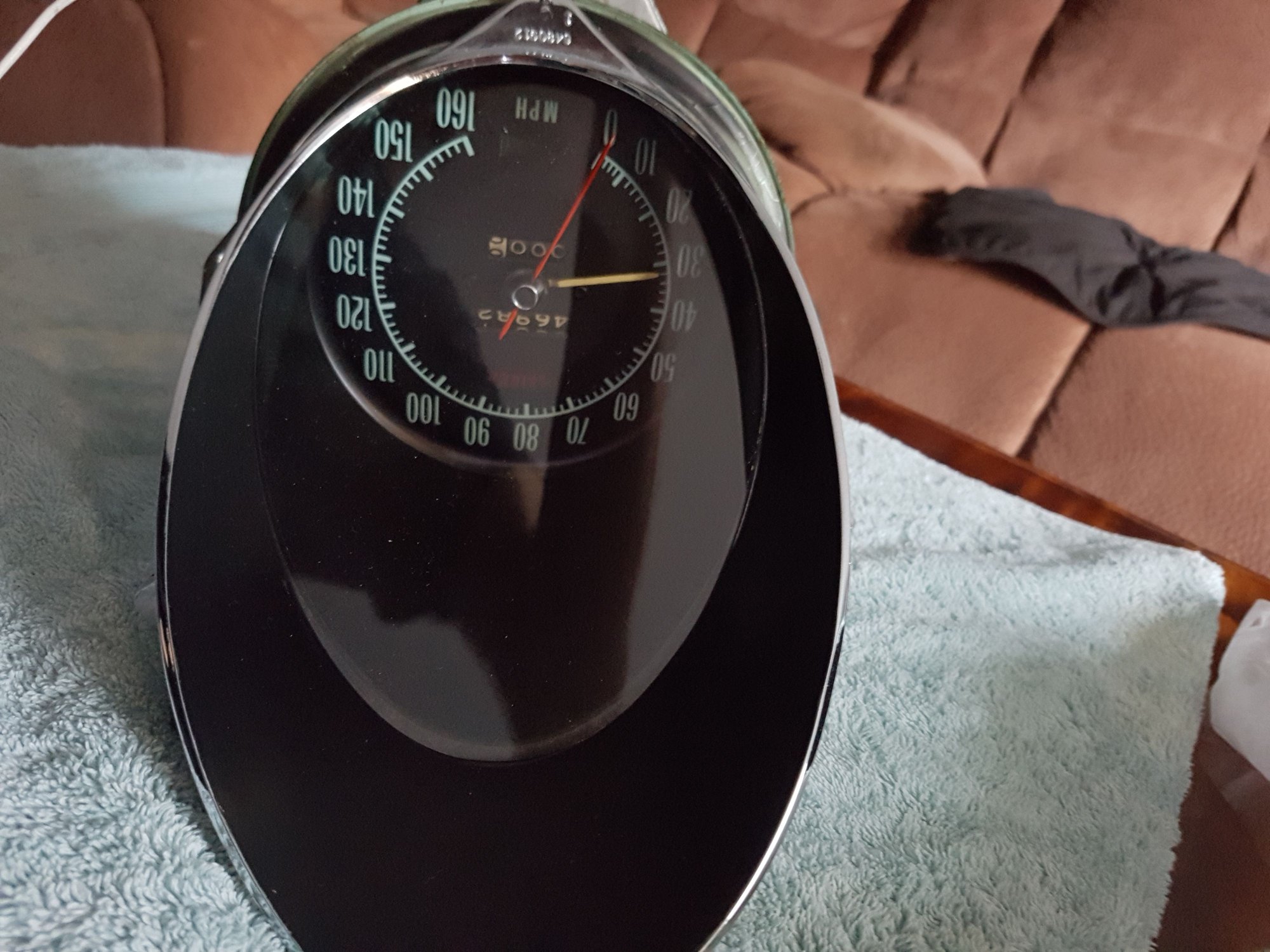

My '68 roadster has the speed warning indicator in the speedometer. What exactly does it do?
I see the thing under the dash to set it but how does it work? Buzzer, lights ignition kill switch?

You set the speed limit needle to where you want the buzzer (alarm) to go off. The speedo needle has a small tab that contacts the speedminder needle and completes a ground to the buzzer. The speedometer needle will continue to go up with your increased speed but the buzzer will continue to make noise until you drop below the set speed. Willcox has a good diagram and explanation of the operation on the Tech section of there website.

See the small tab sticking out on the speedometer needle

Thanks Jesse 982 - never knew or noticed that before. Great picture. Learn something new everyday here on the Forum.

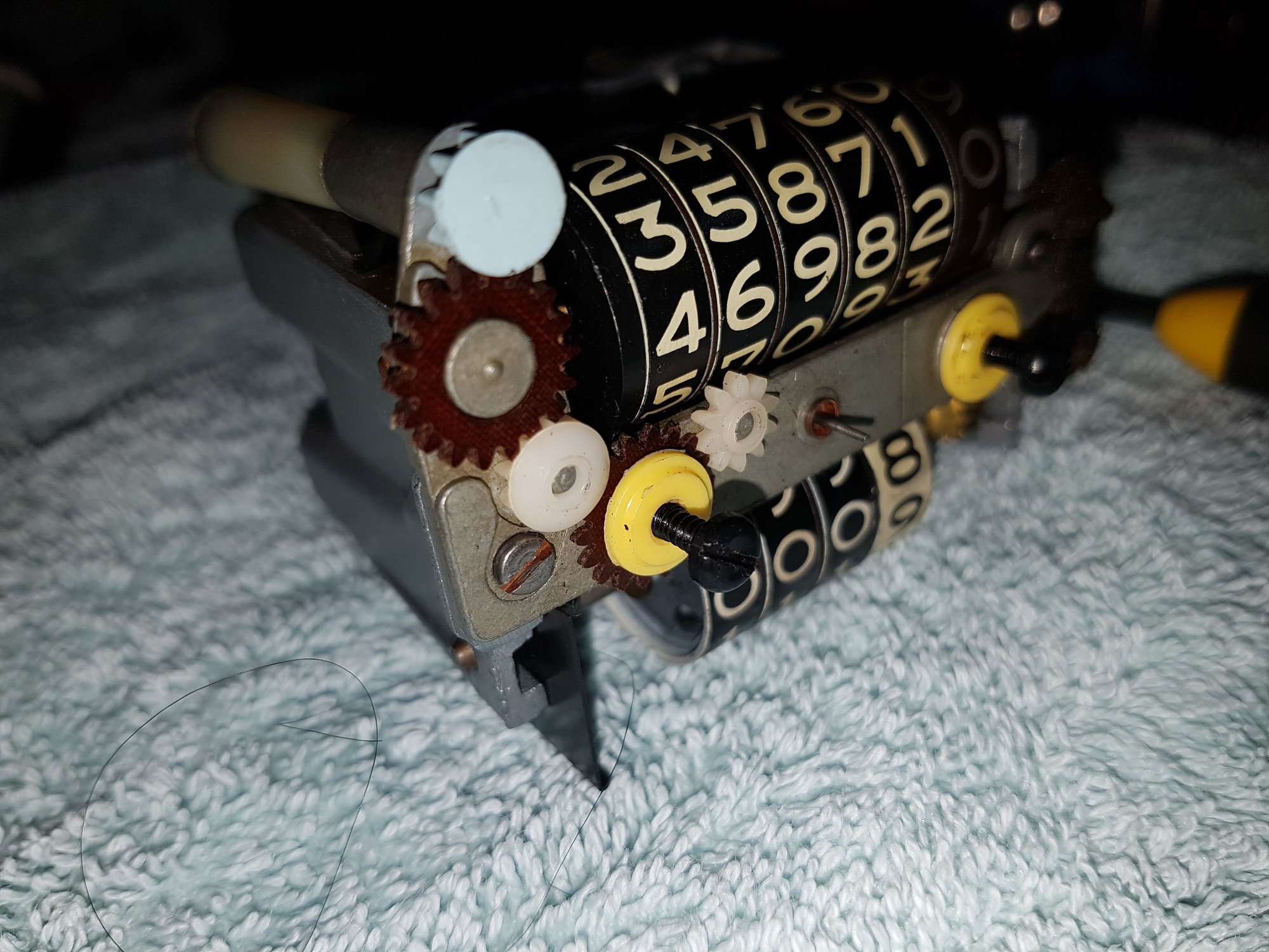

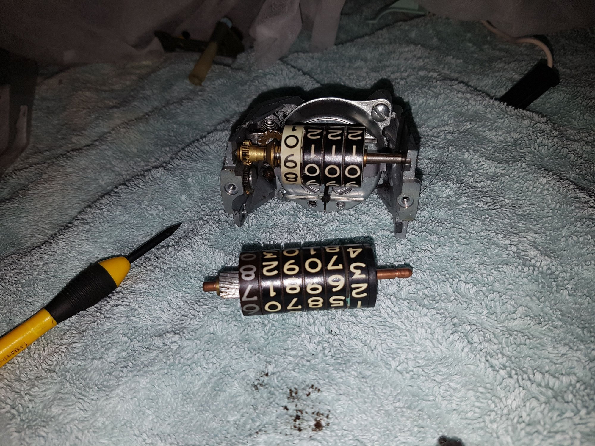

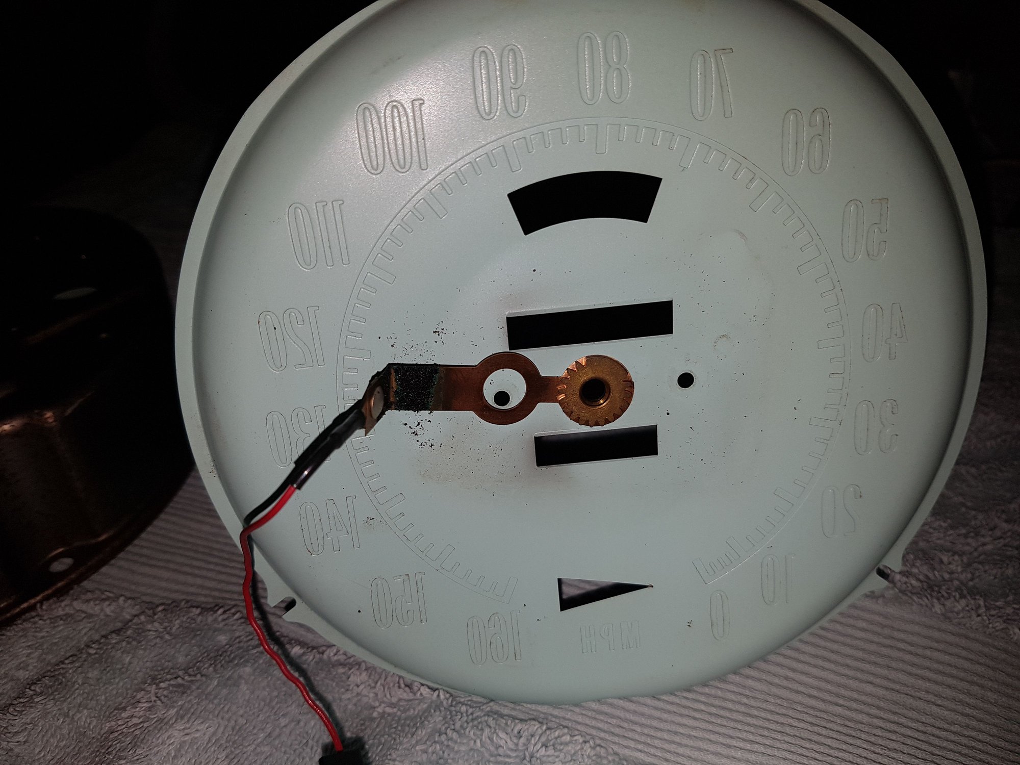

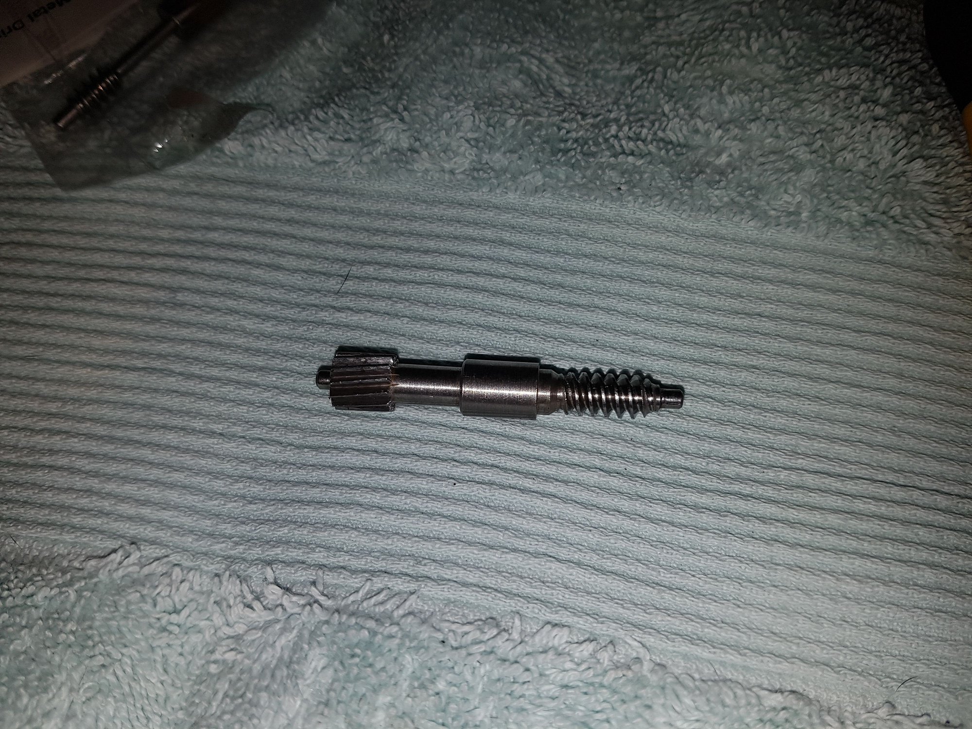

I just had mine apart for a worn worm gear and the are a lot more complicated than a normal speedo ,the speed warning needle is riveted to the face and has a small contact on it to make the buzzer work at the set speed and a lot of small gears under the face .
