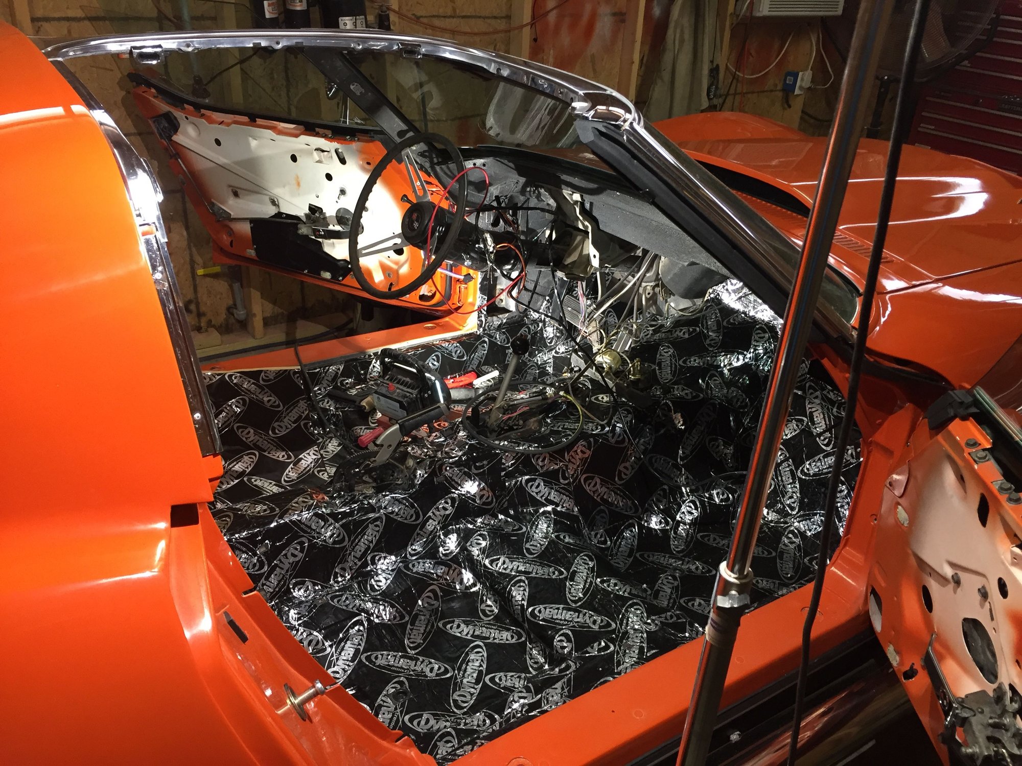

6 year frame off resto. 69 coupe. All new lectric limited wiring and dynamat going in.
Both sides of glass have a truck bed liner coating with ceramic, then this layer of mat inside. Getting close on finishing. Not this summer but next?

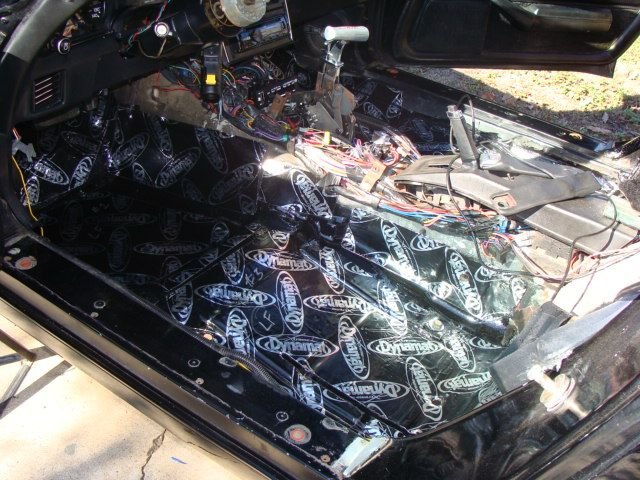

I have a black on black car with glass t-tops. It get's over 100 degrees here in the Summer. The insulation that I used was the Dynamat to isolate the road noise and Dynalyner to insulate the interior. I used the precut kit from Summit Racing. I installed it on my doors also.
My ac system will freeze you out now that I made this modification. It is so quiet inside too. All that I hear are the creaks and pops from the plastic trim panels changing temperature. Lol.
