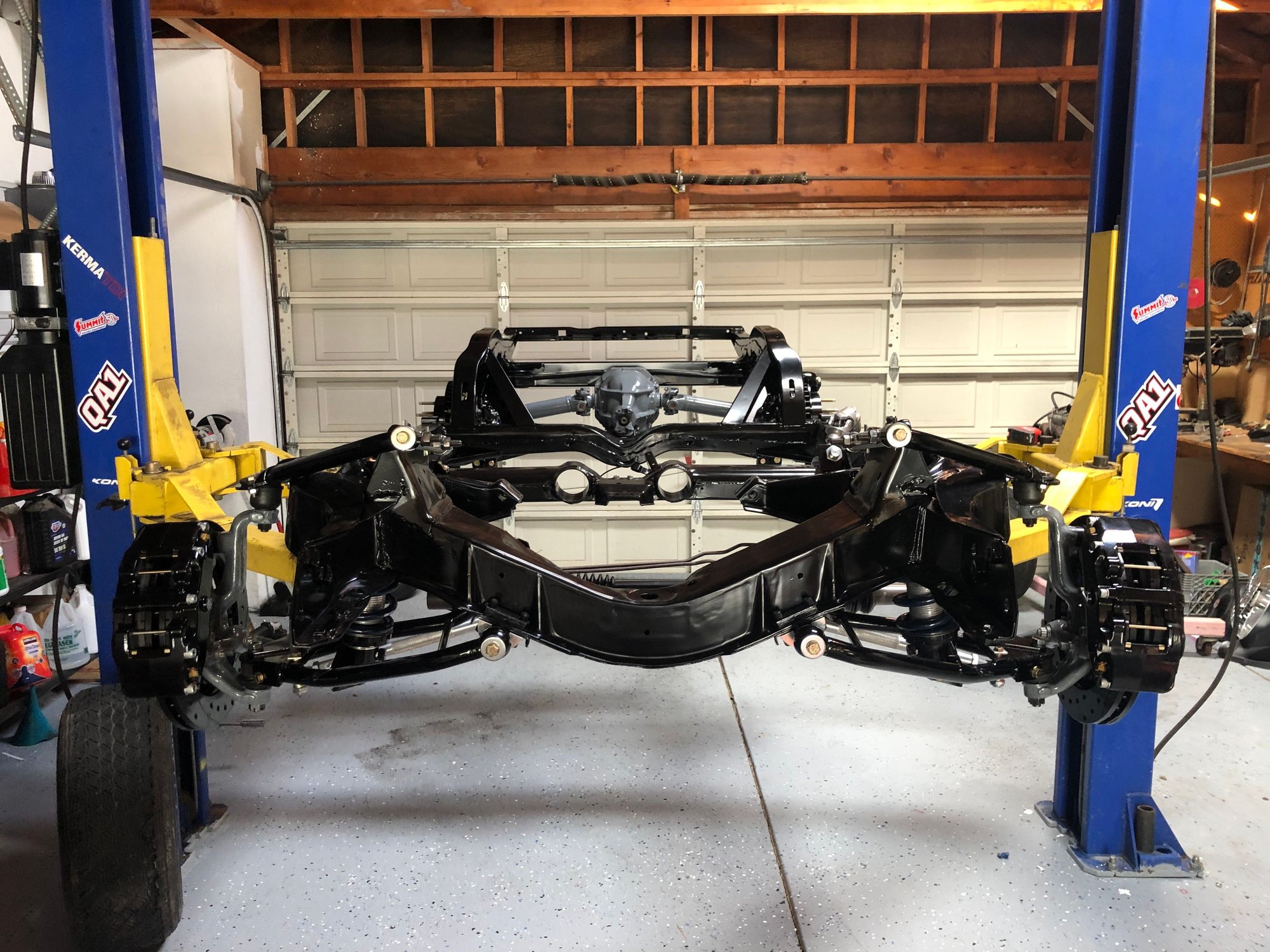

I'm doing a frame off restoration on my 69 roadster. I already purchased all new brake lines but now that I'm going all the way with this project powder coated frame, van steel suspension, Wilwood brakes etc I'm wondering if I should go SS brake lines? Do they really looked maintain a better appearance. I'm not cheap but the steel lines are already in a box in the garage waiting.

Use the steel, you will be able to manipulate the lines easier and less leakage problems. My .02
Your frame and suspension look awesome.
