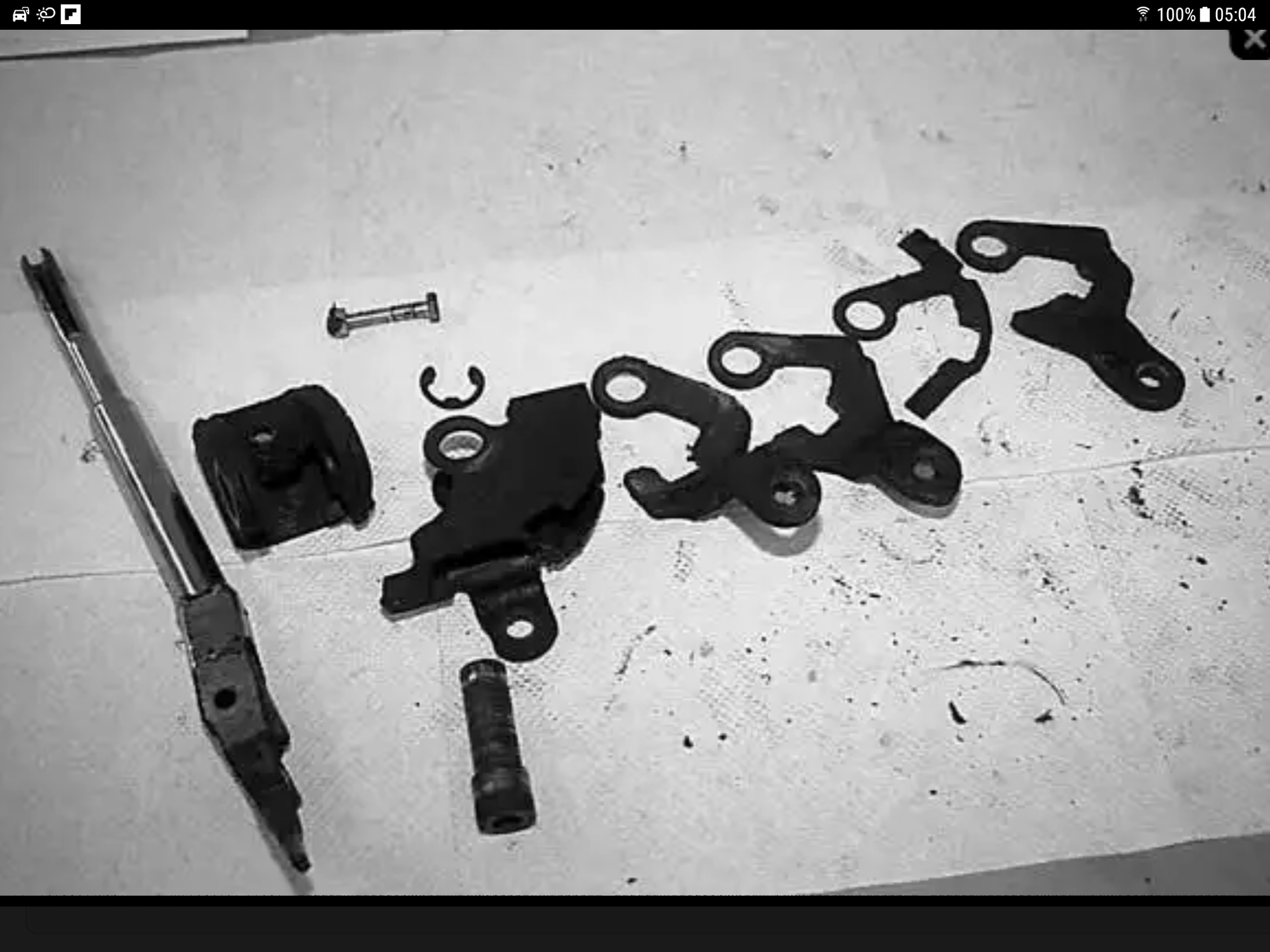

I once had a similar problem. After much wrangling,Ii would eventually get the transmission into reverse. While having the trans rebuilt , I decided to rebuild the shifter and this is what I found.
The piece at the top was removed from the shifter. It is a gate to properely align the shifter handle with the pawl which is attached to the shif
t linkage. This broken piece was able to obstruct the shifter handle as I tried to engage reverse.
Above is the disassembled shifter so you can see where that part goes.
Gene

Pulling up on the lockout handle simply allows the shifter to be moved all the way left so you can push it into reverse. If pulling up on your T-handle allows the shifter to move left through the reverse lockout gate (shown in above post) then it's working.
If you're having issues getting into/out of reverse have a look at the following things (simplest to hardest)
Have you checked that your transmission has enough gear oil? Low lubrication will prohibit gear changes esp at low/no speed.
Is your reverse lockout cable (runs from transmission to the steering column) in good working order - moves freely. You can disconnect from both ends and test.
Is your shifter properly aligned? If your shifter alignment leaves the transmission partially in a forward gear when you move the T-handle to go to reverse you'll have great difficulity. Signs of this: briefly put the car in 1st then easily slips into reverse afterward.
Is your shifter sloppy? Time for a rebuild, over time the shifter "box" or "cube" (see above post photo) that holds the gates gets stretched/expands and you get a sloppy shifter. Rebuild kits include a slightly wider reverse gate OR you can simply chuck the box in a vice and resquare it.
